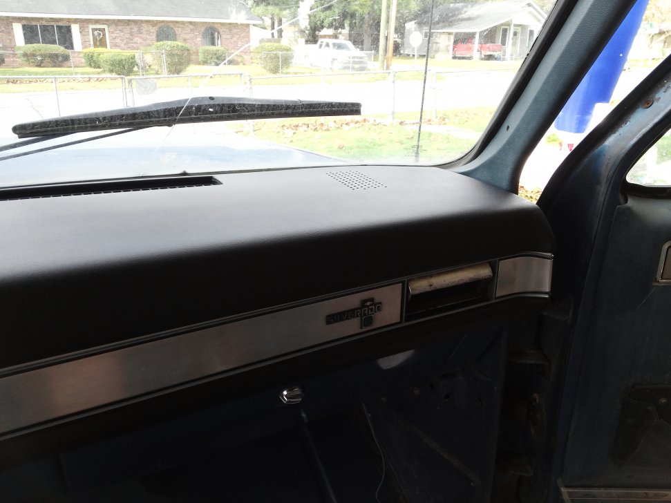

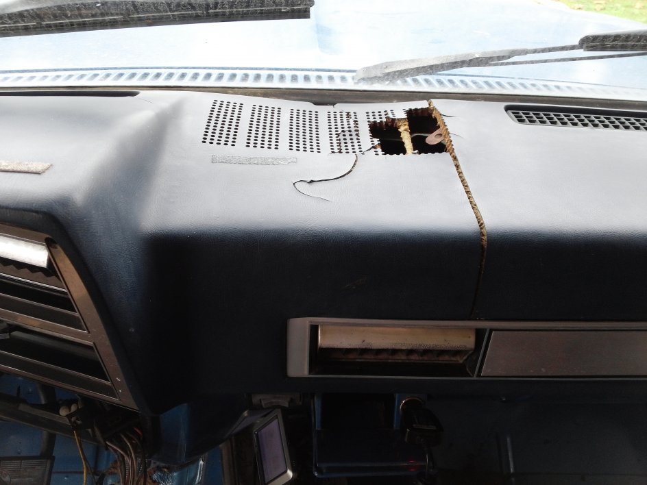

Ordered a Coverlay dash cover and it was def worth the $100. Easy to install and looks much better than the 28 yr old cracked up dash. All you gotta do is clean your dash with a little dawn and water. Wipe it down with some denatured alcohol and glue it down.

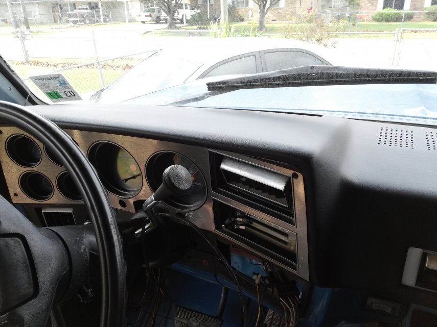

After
Just from my personal experience it was worth it instead of a $200 upper dash pad. Enjoy
