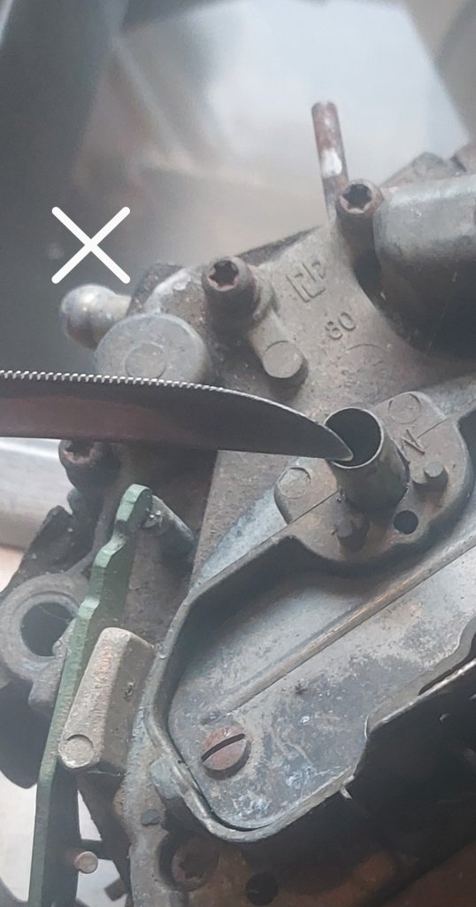

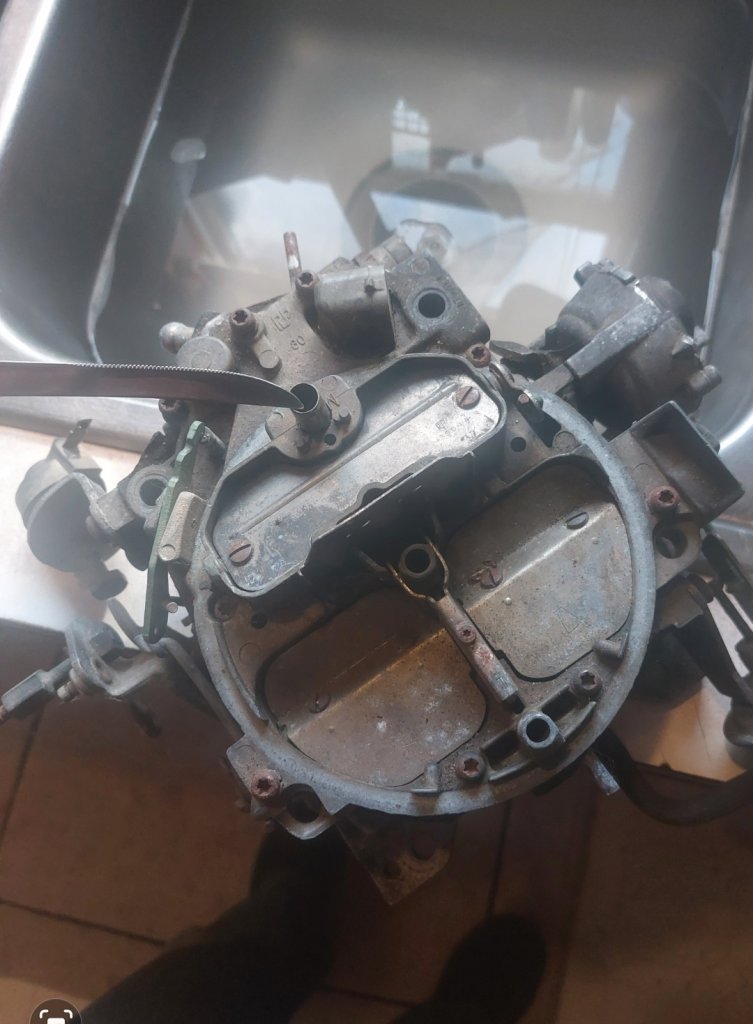

Okay so we know the carbureator functions,if we can get fuel in it. I will try to find pics to verify you put fuel where I said. If that checks out,then remove the fuel line from the carbureator,put open line in an empty bottle and have someone crank the engine. Does fuel pump into the bottle. That will let me know if the problem is before the carbureator or in the carbureator. Post back. Wait a minute or 2 and check back for pics. Okay put up pics for you. Knife tip is the hole to fill through. The nipple you watch for fuel to dribble out of is just above the knife serrations. You can't see the opening of the vent from this angle,I should have taken two pictures,sorry. I put an x by it.
