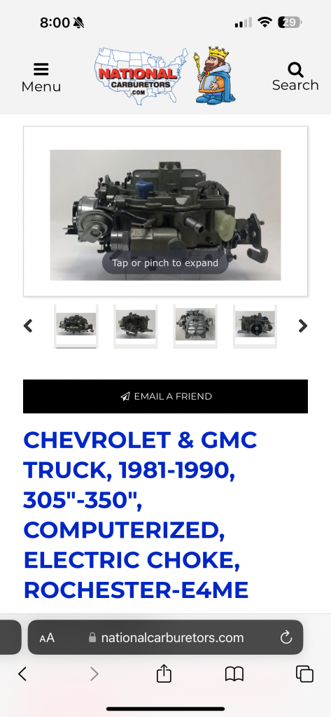

I bought a new carburetor from national confirmed with the staff from national and they said the one I was looking at was in fact the one I needed I’ll attach a picture of the one I purchased. Installed turned it on and ran fine. Now 2 weeks later it’ll crank but won’t fire up opened up the choke flap to see if there was any gas but nothing. I have never ran a compression test on the engine I’m not too sure how you do that. As far as the distributor do I check for vacuum or what exactly do you mean? I’m super new to this so my apologies on million questions.
