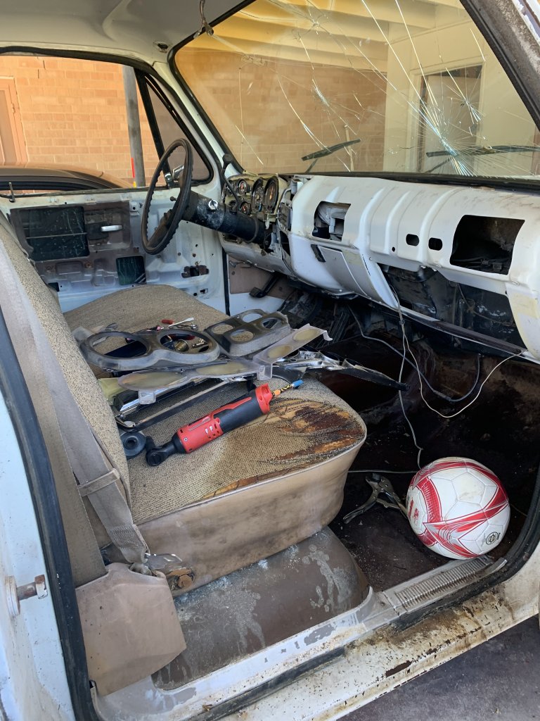

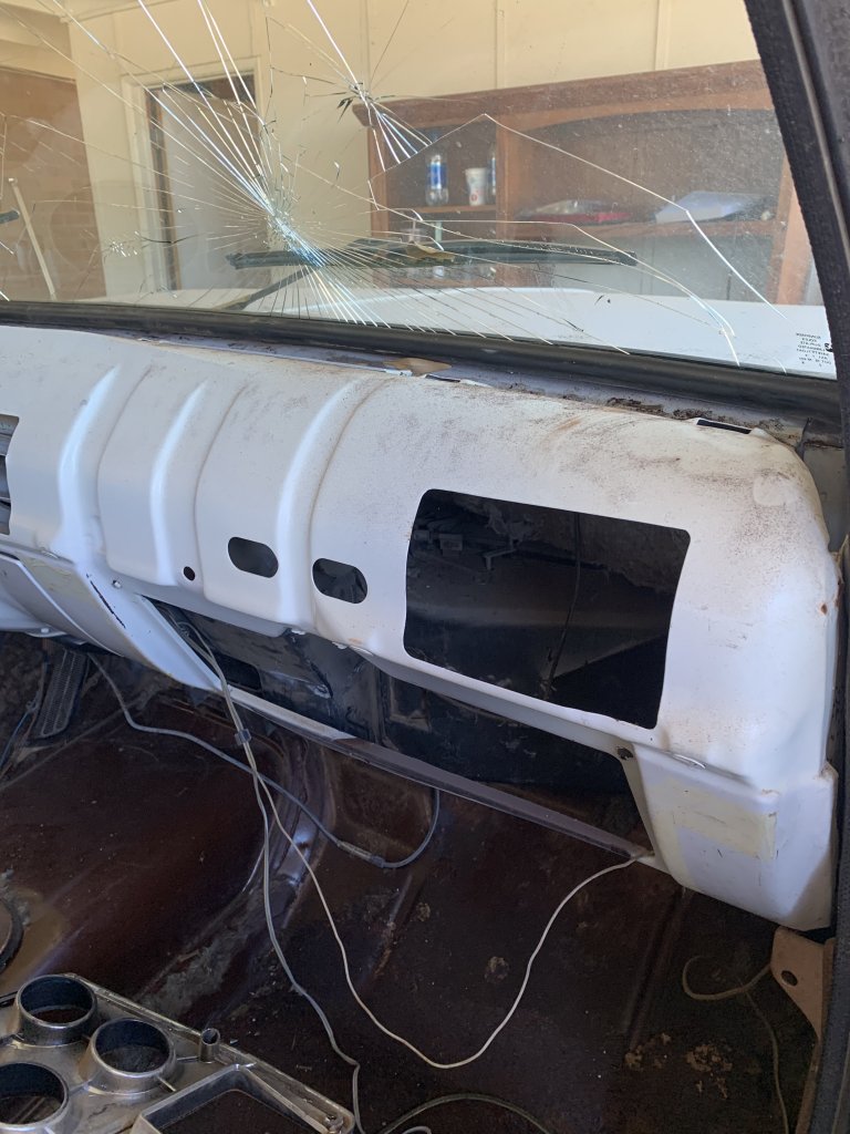

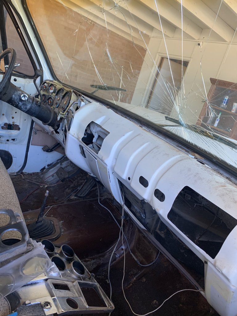

I have 78 Scottsdale I am rebuilding. Yesterday I tore out about all I could...dash, bezel, and about everything I could to replace 44 yr old plastic. I am thinking , I really should pull all wiring and replace with new but my expertise is NOT electrical. Has anybody here replaced theirs with a new set? What's the difficulty level involved and can a weekend warrior get this done?
Anyone's experience and advise would be greatly appreciated!

Painless makes a direct replacement kit for the squares.....albeit for about $700 (sounds painful). I bought their kit that had more circuits, but was for a GM steering column for about $300. I saved my main connector from the firewall, pulled the old wires out and soaked it in gasoline. Rock sells the new (OE style) gang connector terminals. The wiring is labeled so just gotta get a diagram and put them back where the originals were.
Its a huge job regardless - doubt it can be done in a weekend, but maybe. Lots to do and keep track of, but very worth it in the end.

Electrically, these trucks are about as easy as they get. The dash/engine harness is basic depending on if the truck had gauges or idiot lights. Any options the truck might have had used its own harness that plugs into the main harnesses and fuse box.
I know American Autowire offers premade ready to install harnesses. The painless stuff requires you to use your existing steering column/turn signal/headlight plugs. Not good if your connectors are missing or damaged. That also means a bunch of extra connections and splices.

hows the condition of your interior harness? if its okay you maybe dont want to touch it...
but engine side you would not be unwise to replace and the rear running harness check its condiiton.
But you have a 78 so glass fuses. a newer column and nicer wiring may be what you desire (a 1980s with the column stocks, or a 79-82 with the same high beam and wipers you have now
Tilt may be desire able too

If your set on going all the way painless and American auto wire have end to end kits that are well made, I personally went with painless but you’ll get the same results with either. It can be done in a weekend (I did it in two days) but plan on 4 days minimum if you aren’t comfortable with wiring. The most important lesson learned is take the time on a table to separate all the wires and bundle them up together based on the path they will run. Spend the time doing the prep before you even take it near the truck and it’ll be a whole lot easier to drop it in and start landing wires to devices instead of fighting a spaghetti nightmare and getting frustrated.

I did the painless direct fit kit in my truck last year. Worth the extra money in my opinion. The manual is very thorogh and well laid out for everything and with a couple simple tools, it isnt a difficult job. Just take your time and dont rush and everything will be fine if you follow the manual and route wires safely.

I would go with whichever kit had the least amount of connector work, i.e., soldering, crimping, etc. My experience with American Autowire was good, but tons of work.
