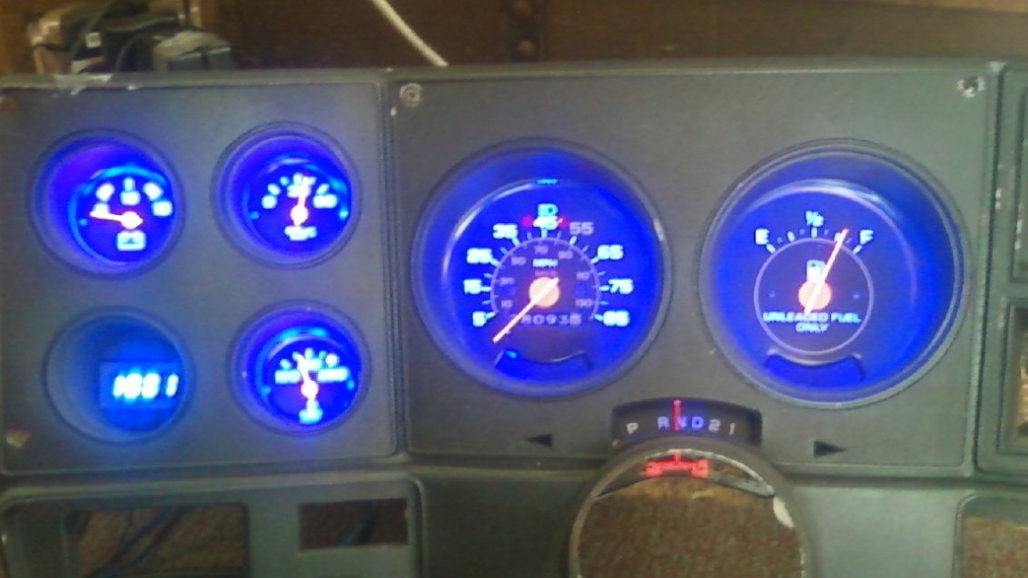

i have a sugestion,send me yours and ill refurbish it or sell you
one of mine?Put you in a digital clock.....thanks evan:favorites37:
