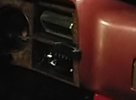

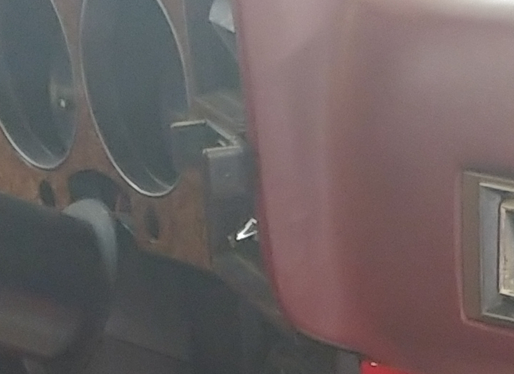

You can try putting a thin screw between cig lighter and the tray to make it slightly tighter. Some PO put couple of screws into mine which made it so tight that I could barely plug anything.
BTW I recommend a mount that I made using L shaped piece of metal and a "vent" type holder, screwed to it, you can glue it with a double sided tape in the gap between dash pad and a dash. Very solid and would not leave any visible residue if I ever want to remove it. I don't have any better picture rn,
