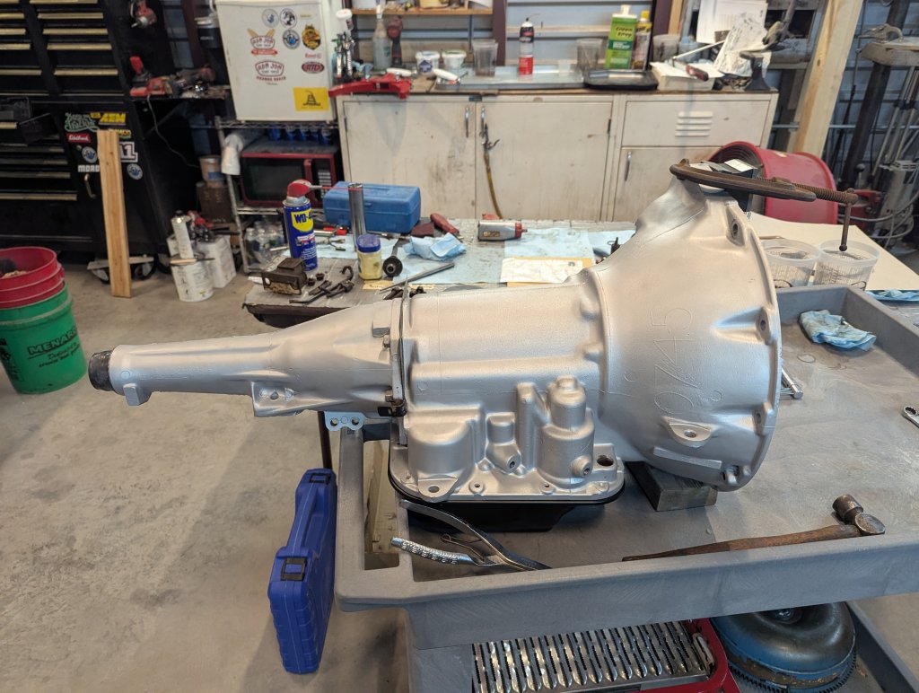

You could always get some of that aluminum look spray paint, I think one of them is called Alumicast? I've used some on brackets before and they stay looking good longer. I supposed you could even clear coat it? Though that might yellow over time

I used Seymour Alumi-blast on my 904 transmission case.
pxl_20250705_165043921-jpg.400085
