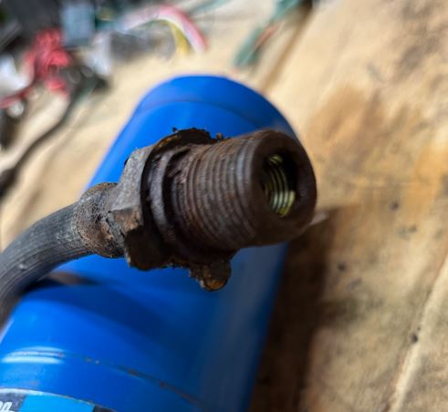

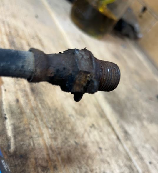

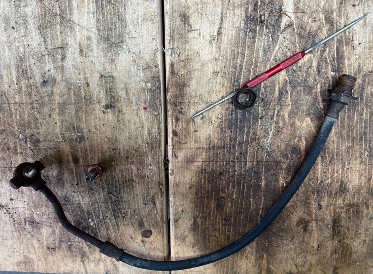

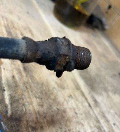

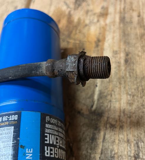

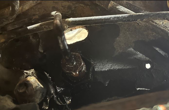

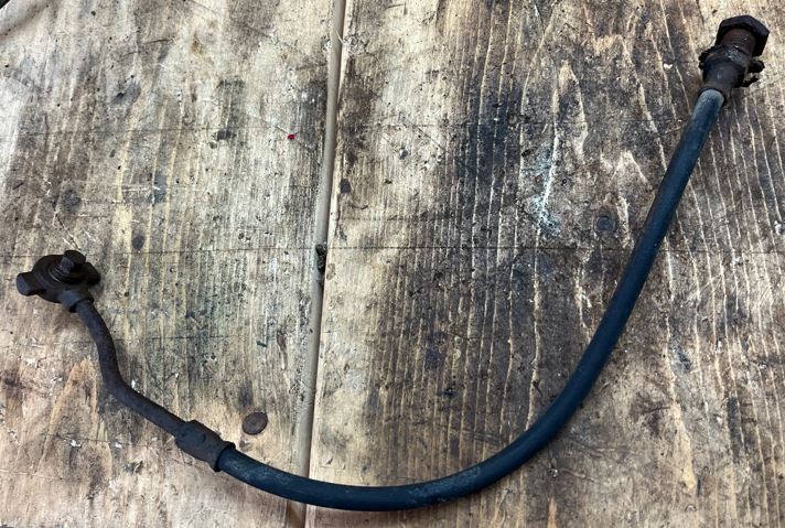

Trying to change the front driver side rubber brake line on my 1980 C20. Like everyone else that I’ve found online it’s not going easy like you would want it. Come to the conclusion that I need to do like others and remove the clips and use a vice grip on the flare and a 6 point wrench on the old brake line to remove it. For the life of me I’m not understanding where the clip on the inside is at. All of the pictures and videos I’ve seen it’s already removed and is U shaped. Only thing I’m seeing is the socket shaped piece, but do see in the pictures I took. Some teeth shaped tabs on the inside to hold the threads. Along with I’m guessing you hit the clip on the inside of the wheel well with a chisel until you find the split as mine looks like a solid washer. Figured someone might could point out something obvious that I’m over looking since I do that a lot. And yes I know that area of my truck is nasty as all get out. Hoping to put it on the trailer and take it to work and hit everything with the heated power washer.

Hose is keyed in frame. Only can go in one way. Otherwise, hose may kink or rub against something. When loosening nut, hold hose against frame on opposite side or it will spin.

Loosten/Unthread that stamped nut in pictures 1,2,3,and 4
Thanks I was thinking it would unscrew, but I have torn up so much trying to fix something at work lately. It’s gotten me gun shy on just doing what my gut tells me. Trying to find a friend with a 15/16 crow foot at the moment as a wrench just doesn’t fit in there. That and I don’t feel like buying a whole set and it not work. Another night of Kroil oil soaking won’t hurt either.

On a good note the line is changed and brakes are bled.
