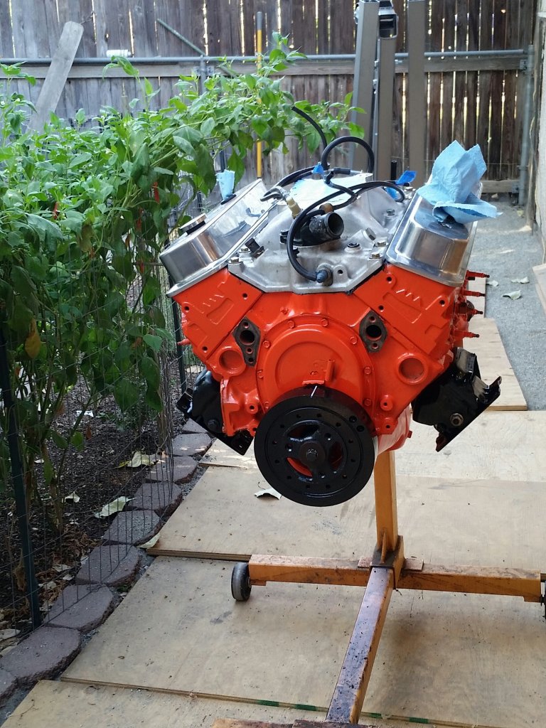

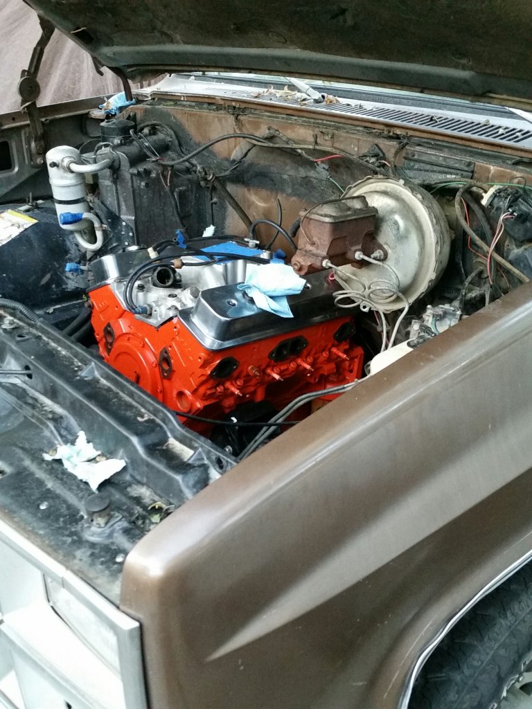

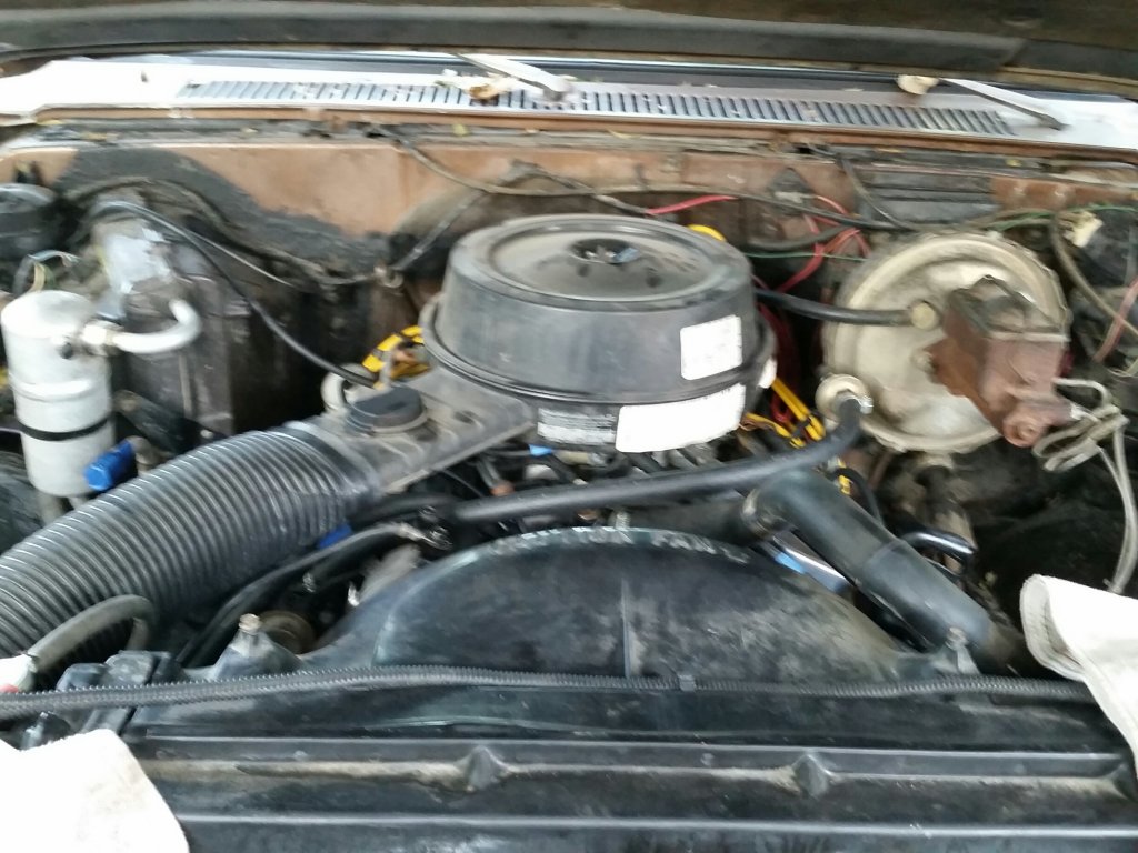

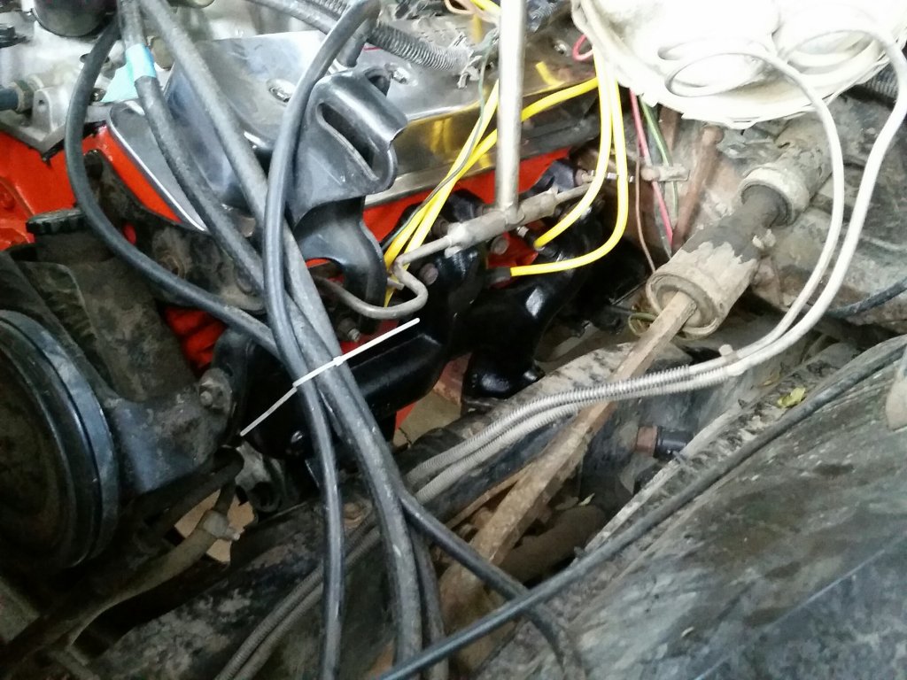

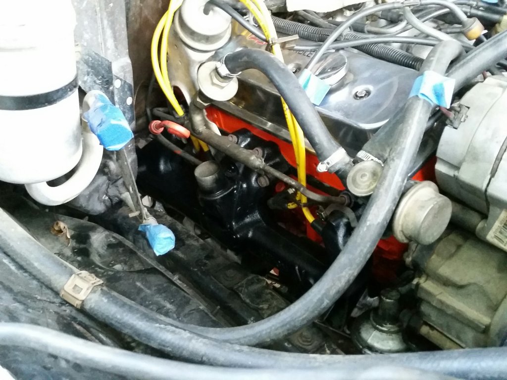

Carbed Vortec 350. Works great! Yes, cold temps you need to feather the throttle to take off from a start, but once it is warm there is no issues. Runs strong, good torque, pulls hills and hauls with ease compared to the smogger heads. The only upgrades to this engine is an old school 327/300hp camshaft, vortec heads, gmperfromance spreadbore intake, and different jets in the carb. Used the heater core return to the radiator for the coolant bypass.
If you go this route, get the self-aligning rockers. I didn't know about this and used the stock non-self-aligning rockers. It worked fine for a while, but then number 7 exhaust rotated off the valve stem.

Thanks! I for sure appreciate the pictures. It looks great! That's exactly what I would want, better power for towing and hauling. If you have ever checked I'm curious what your getting for mileage.
