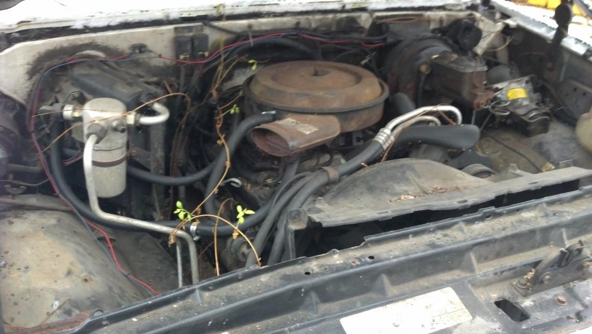

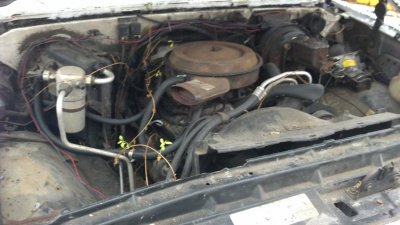

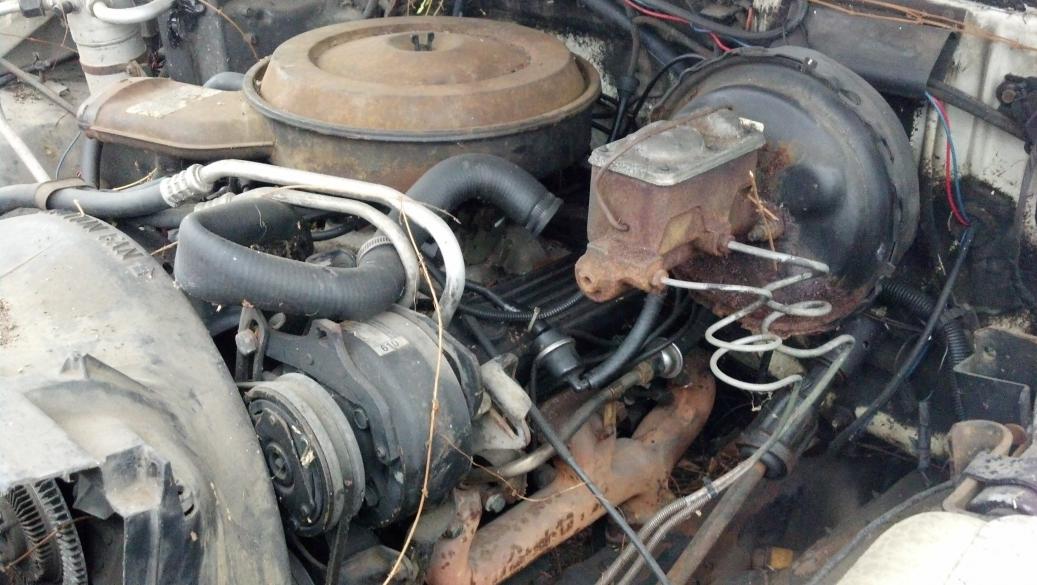

Here r some photos. I really don't want to spend $350 on a wiring harness. I'm good at labelling and rewiring. I have no fears about the engine compartment, I'm just nervous with how much I'll need to wire up inside the cab

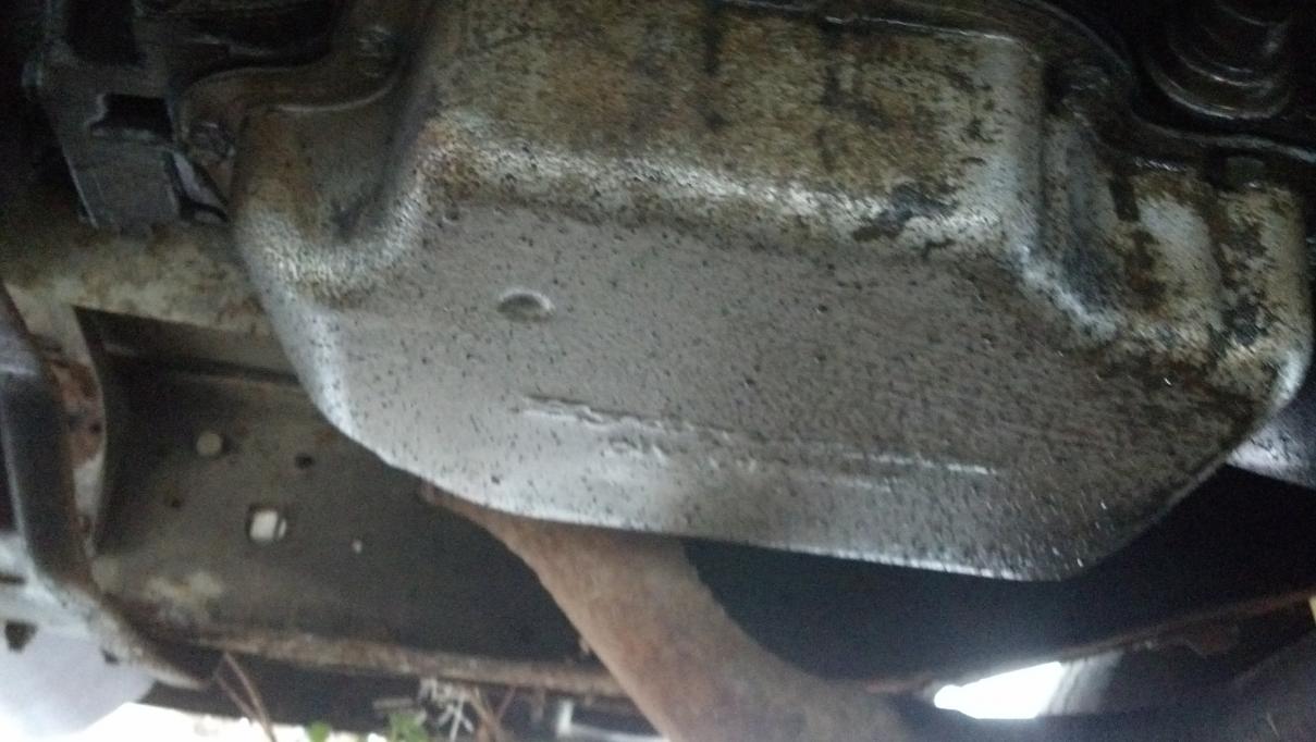

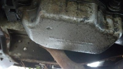

Transmission unknown. Im not properly dressed to crawl under this truck now in the snow. But here is a photo of the pan

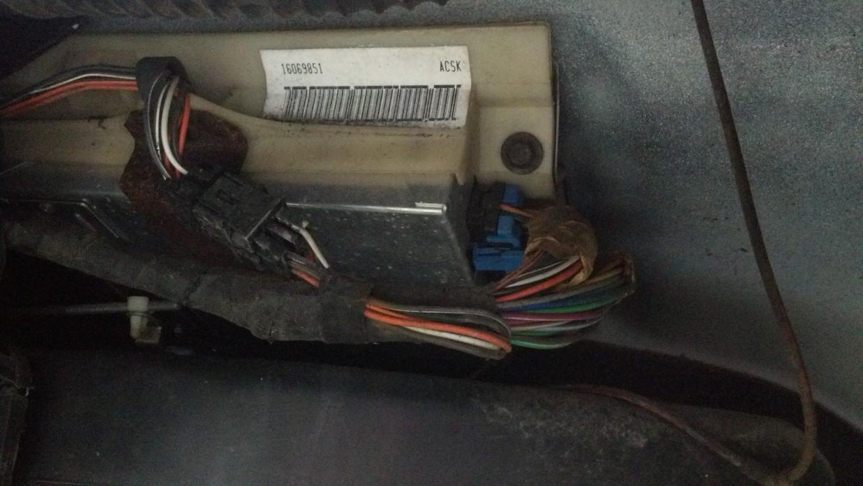

If you have the complete truck, thats great. the ECM is behind the glove box, and its associated mounting plate will bolt right into your 85. You can pull the wire harness out, and with the diagrams we have here, and a good digital volt meter, you can customize the harness to be stand alone, leaving the 85 starting and charging harness in place. I would also install new seals and gaskets in that engine before installation. Nothing more irritating than a shitload of leaks after a swap.
The 87 manifolds should work just fine with your current exhaust.

Trans is a 400 in the 87.
you will have to use the wires and plugbfrom the 85 trans to make the computer control lockup....unless you swap the 400 in as well.
