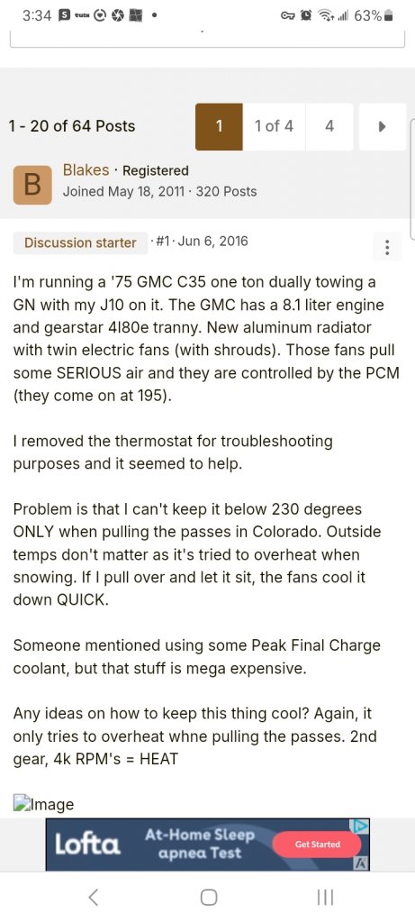

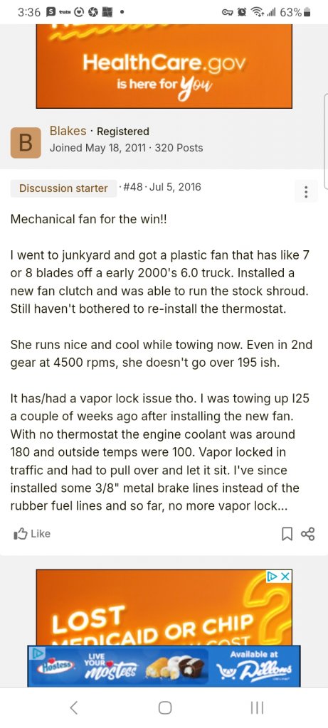

I saved you hours of reading. This guy tried everything. Look at his 1st post vs. What fixed it.

Fan clutch. And there's a bunch of info on the net about fans that have the most CFM some guys are running some ford mechanical fan,the guy in the post I screenshot is using a fan from a 6.0 express van. Further reading reveals Summit recommends a mechanical fan on 4 cores also From what I can tell the best electrics only pull 5000 cfm and average mechanical fans can do more than that. And I think pretty much any factory truck with a tow package runs a mechanical fan. As to the power loss,not much if you have a fan clutch,and even electrical fan is not free horsepower,it still is a significant draw on the battery so the alternator robs power to generate more amperage.
