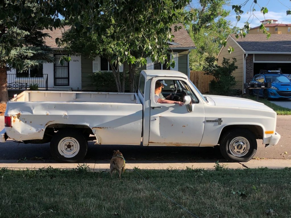

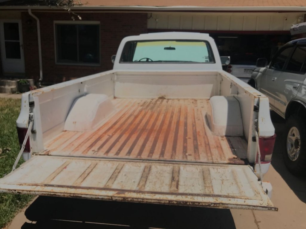

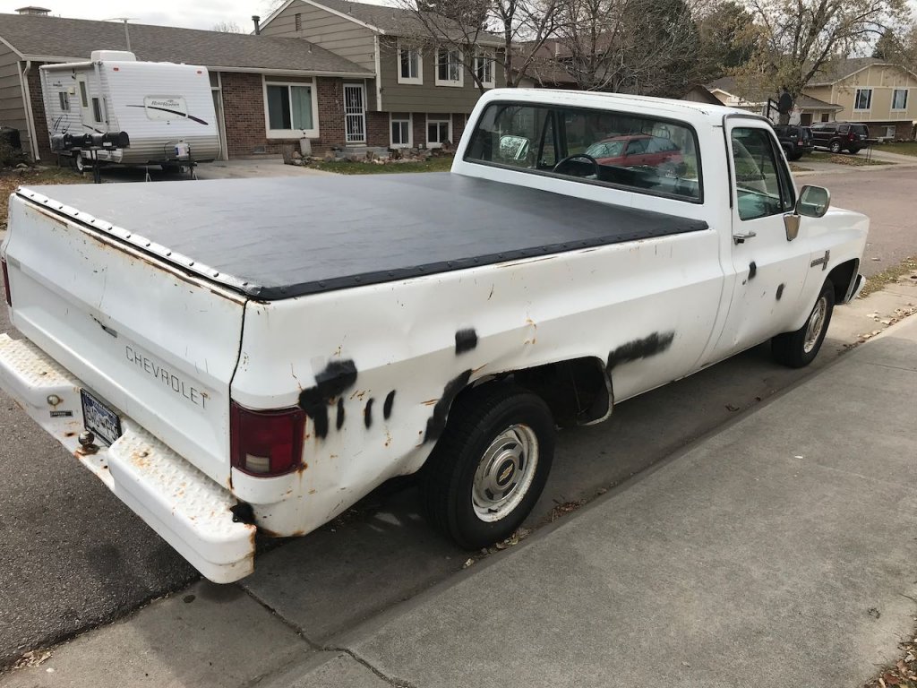

My almost perfect truck needs some work. I'd Like to cut only the outer panel off the bed and weld in a bought patch panel or outer panel complete. . See photos. The inside is so nice, I'd like to keep this original bed.. These are older photos, but I could not pound out these 17 year old dents. The door dent just popped out. The black paint was rust preventative and has now been painted over

Outer panels are available, LMC ect. It will take a fair amount of skill and body experiance to pull that panel replacement off. It is doable but if you have not done a weld on panel replacement before, a friend that has or a shop will be your new bestie.

It could be fixed but I would get a replacement panel. That ding has stretched the metal quite a bit. Side boxes are long and basically flat. Waves will show. The shadows in the second picture show it is bent to within a foot of the cab and all the way to the top rail.

As easy as bedsides are to replace I'd unbolt it and put a new one on.
4,906
6,845
Washington
A new bed Side, or a new Bed?
Just a bed side. But even after spending $600-800, you’d be comparing that against a lot of hours of bodywork and likely not a great end product.
Unless you literally have endless time on your hands, a great deal of skill and a rare or irreplaceable piece of sheetmetal. Or no budget an availability, replacing the panel is the best option.
That said, you’re in CO so there’s a great chance of finding a rust free bed that only needs minor bodywork for the same or less than a new panel.
Up here a straight rust free bed like that would fetch $500 tops.
Buddy got a straight 8’ bed for his 72 for $800 and that was from a guy who sells 67-72 parts for profit.
Nice part is, you can remove your bed if you find one close and plop the new one on with a couple bolts and drive it home

In my opinion, a few different ways to do this, and depends on what you want your outcome to be when completed. You could replace the side as mentioned above. You could also replace the whole box with another white one if you found one somewhere, and basic tools to replace it, or of a different color & spray the new one white. Then sell yours off to re-coop some money-->I would do this first if I were in your shoes right now. I agree with @Grit dog
I have the tools, so for me personally, I would not be afraid to be working the crap out of that steel to get it back into shape.....I am strange in the fashion of trying to prove to myself doing countless hours of crap to fix something that probably isn't worth the time :anitoof:
Simple dent puller anyone can make: 16d nails to use as studs to tack weld on & a vice grip with a modified handle---remove the threaded clamp adjustment, put in a long piece of threaded rod, have a drilled out steel tube to use as a hammering handle, double nut the end to keep hammering handle in place & use for adjusting the clamp to the nails.

Thanks all (so far) I tried straightening it last year. No luck that metal was bent way out of ever coming back. The choices I see are welding in a patch panel, replacing the entire panel, or a bed swap. This bed is so nice inside (and I have a crane in the back) that I think I'm going to eventually get a complete bedside and replace it. I guess there is cutting where the bedside meets to top side of the bed, front of the bed, and around the taillights. Then weld top and ends, and bolt the inners. If a bed comes up before I start cutting, then thats the way I'll go. I was kinda fancying picking up a bed and bringing it hope atop the bent one.. Maybe put boards in the pockets and then dropping new on top upside down . That would be kinda cool. Adventure, that's what you call it.
1,213
3,033
Hoschton, Georgia
One thing to keep in mind about welding in repair panels, there's a high risk of warping the panel and also 10x the amount of finish work before painting. Me personally, I'd replace the bedside, whether it's a new one or a good original. Other than the 2 tack welds on each rear post, the whole thing bolts together. Since yours doesn't have a gas door on that side, we've got those in stock right now:
