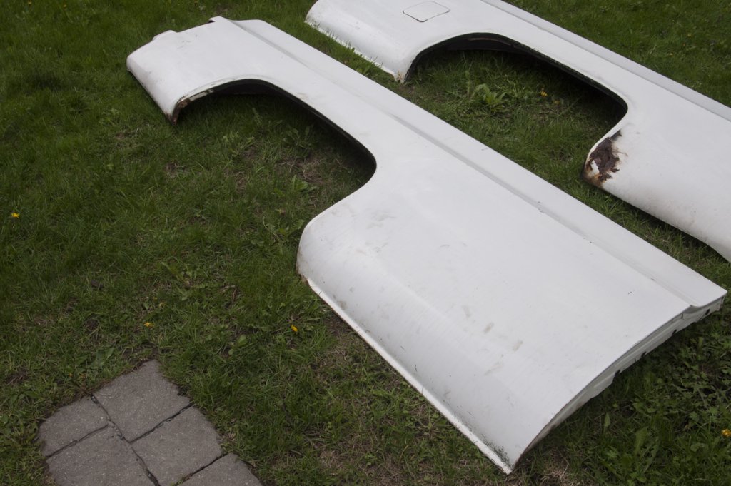

bed side are easy to swap! :)

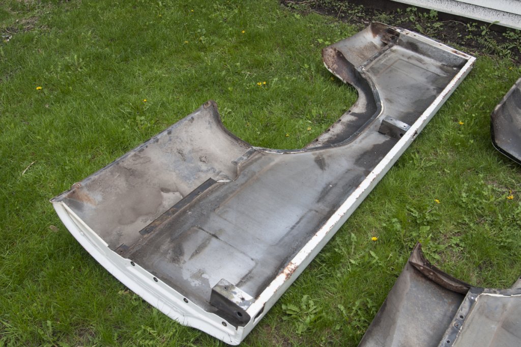

What I did not realize as the inside of the bedside is sold integral with the outside! Like I said. If you cannot fix a chevy square body, you should sell your tools.

I havent seen it mentioned... but there is one weld near the tailgate, otherwise bolts
