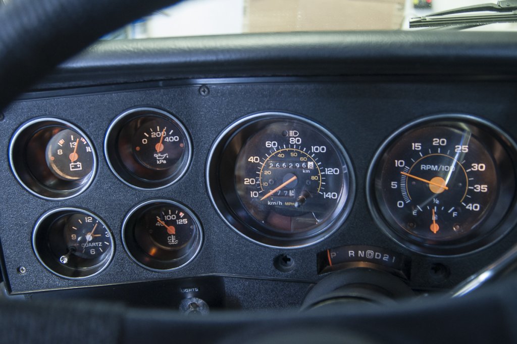

TPISly-C10
Apr 1, 2019
615
896
Boucherville QC Canada
Sly
C-10 shortbox
LQ4 6.0L
The only things that are really different on the medium duty cabs is the hump in the floor and firewall, and the instrument cluster and bezel, depending on the feature set of the truck in question. The dash pad should be exactly the same as a light truck of the same time period.
instrument cluster is the same ;)

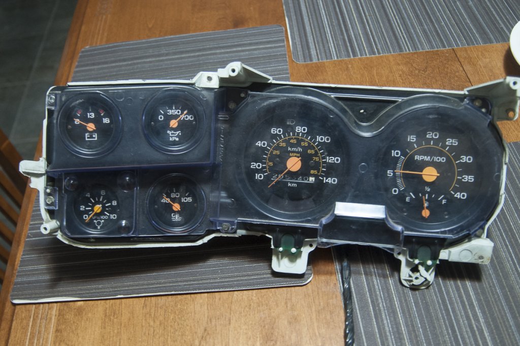

The cluster may be the same physical size, but the gauge layout is much different. The tach with embedded fuel gauge was never used on the light duty trucks, and it’s only a 4K tach. I’m also not sure about the pin outs of the large plug for the cluster.
The trucks with gasoline engines would have a 5000RPM tach with a fuel gauge. Some diesels had the lower 4000RPM gauge. Yes, you need to repin a couple wires. You also need use the resistor from your original large fuel gauge.
What's the gauge in the lower left?
Boost gauge for a super charger?
These trucks would havd a vacuum gauge for juice brakes, or an air pressure gauge for air brakes
TPISly-C10
can be retro fit with few mod :)
