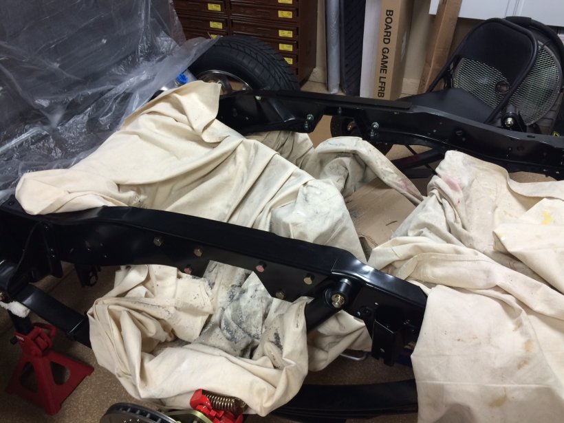

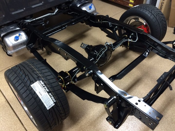

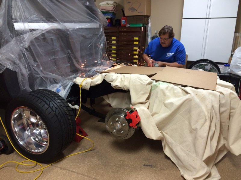

I always go with the c-notch when doing a flip kit, its worth the time for the extra axle clearance and to reduce bottoming out on the frame during heavy loads. Not a hard job to do, took us a few hours. Maybe longer than most as we had to take extra time to protect the finished body and frame.

Great looking job, It shows that you have patience, with you
