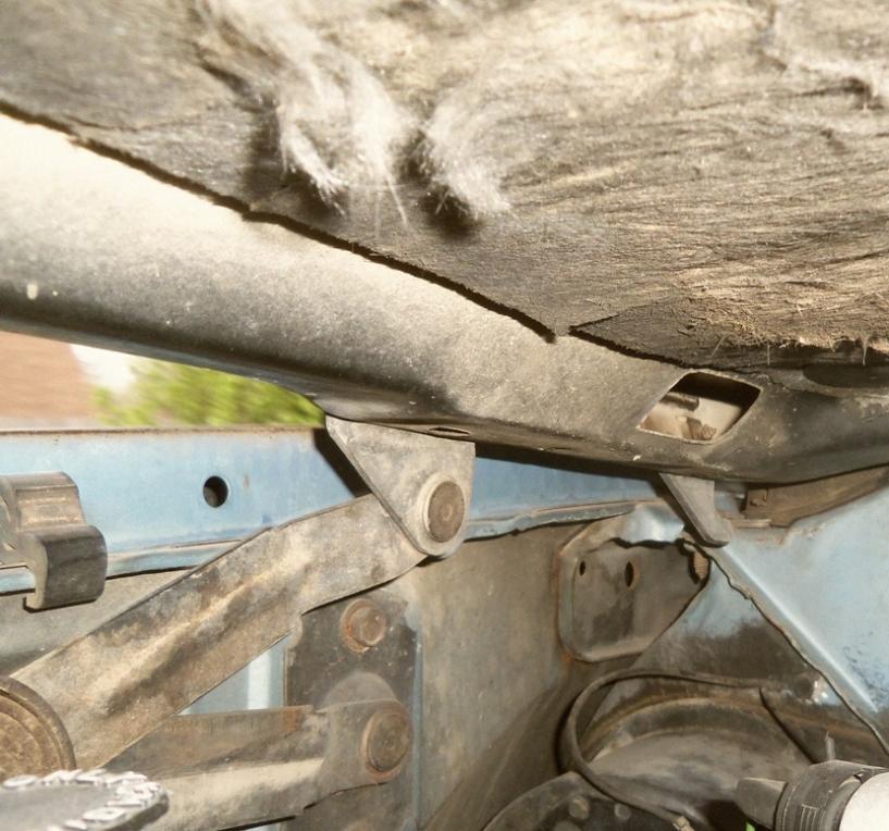

In the later model squares, as in 81 and later squares, the Anti DeCap does happen to be part of the rear hinge.
See the hook? Notice the rib on the firewall that's running at what looks to be close to a 45 degree angle?
attachment.php
Now with the hood almost all the way closed, notice the location of the hook and imagine what would happen in a hard frontal crash. See the rib on the firewall? The hook catches the rib and the hood stops after traveling about an inch rearward.

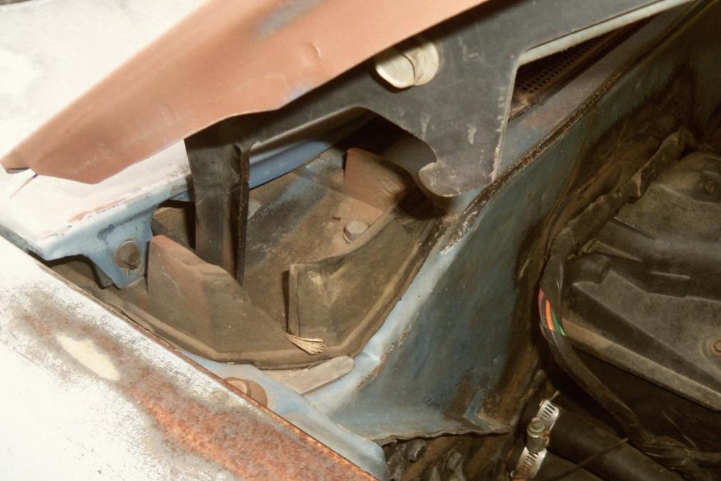

Here's a pre-81' anti-decap device. These were also usually in the corners as well, I believe.

So the hood actually comes down over the top of those, and why they're adjustable huh???
