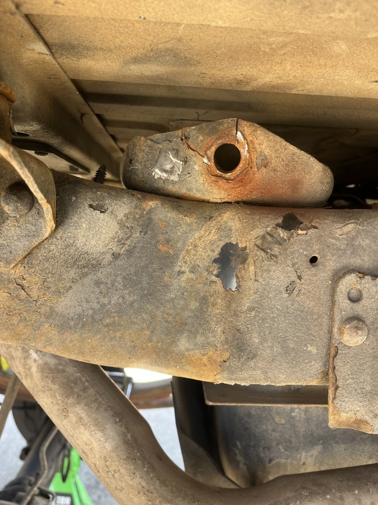

Busted rear shock mount
Slooptin
Mar 6, 2017
174
112
Denver
Vance
k30

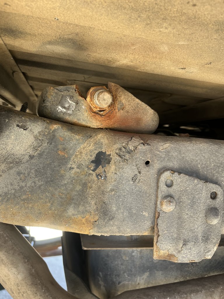

In the process of swapping springs/shocks on my suburban and discovered the rear shock mount broken (see pics). My first thought is to break out the die grinder and welder and just weld it back together. Anyone have any thoughts or other options? I’d like to avoid pulling the body off the frame just for a shock mount

You could drill holes on either side of the break and bolt a plate (with a hole in the center) to you existing shock mount. Or just weld that missing tab back in place. Why would you need to pull the body to weld that? If you can take that picture, you should be able to get a stick welder in there.
NOTE: If you do weld it, make sure your fuel tank is absolutely 100% Full including the fill tube if possible, and weld it outside. Liquid gasoline is not flammable, so make sure there is no room in the fuel tank for gasoline vapors.

I would do the suggestion above with welding it.
Use a support washer like this
And a brace from off-road design

If it were me? I wouldn't just try to weld what's there back together. Probably just break again. At least put a plate over it. Dill the hole in your reinforcement, grind that old surface clean, pop a bolt in there to keep it lined up.... and go to town. Might need a longer shock bolt?
Yeah I’ve got a welding blanket and some magnets to go between the tank too. Was worried about pulling the body to get a good bevel on both sides of where I would weld and I can’t reach the back side so I’ll probably bevel just one side.
Since forever. It’s the vapors that burn.
Good call on the washer. I’ve got some scrap steel sitting around I’ll probably make one from. And I looked into that but it says just trucks and blazers, no suburbans
