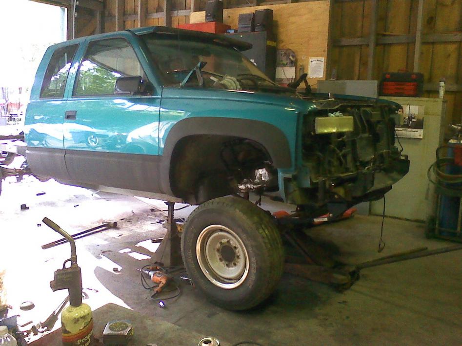

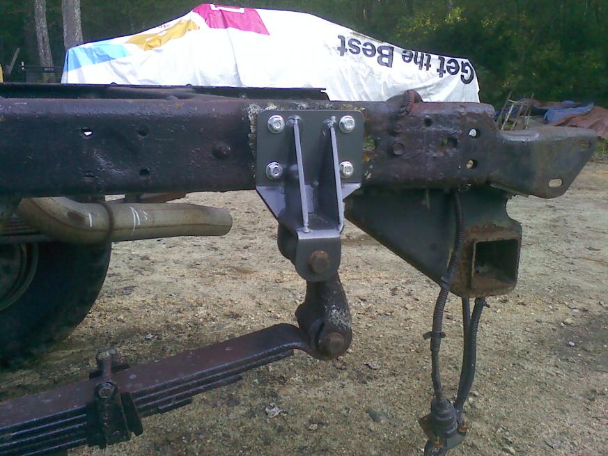

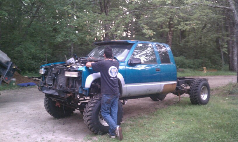

my older brother bought this truck and blew the motor. so he ripped it out rebuilt it and is now in the process of doing a solid axle swap 6 inch lift in it. here are some pics. enjoy.

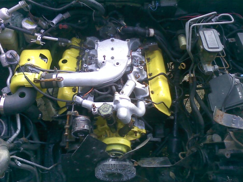

yeah jason thats my 86 dually im building ive got that thread going on to. right now im waiting on finding somone to make me custom headers. or either that im making them myself. for now because money is low im using 2 GM-8 turbos with Heath diesels Turbo master wastegate boost control to hold the pressure longer coming in to the motor

its such a nice swap chris. he used the kit from off road direct. bought 80s front leafs soft ride 4" lift and found a dana 60 ford axle with a high pinion. you could use a cehvy axle but you have to flip or swap the t-case. but i love the SAS

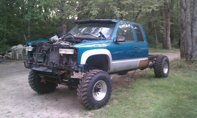

pics

Thanks for the update and pis. What are you doing to connect the steering gear?

he is using a cross over steering kit from ORD
