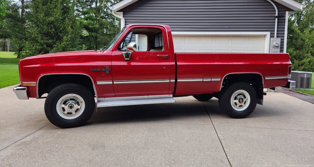

Thanks for the advice. I made an extractor by grinding a bolt into a square, got the first one no issue. It slipped with the second one. Obviously not a great easy-out. Yesterday I purchased a set of easy-outs for hollow / soft metals, to minimize expansion of the plug. I cut apart a plug that came out intact, and measured the ID of the threaded part, it is .338" with a dial caliper. Is drilling to 3/8" (.375") needed? If yes, I have to remove the inner fender. otherwise, how much heat do I apply? Quick and hot from my oxy-acetylene? Or more gentle from a plumber's torch. I'm 60 years old, worked on cars forever, never broke a plug in my life until now. Thanks again. BTW, here's the truck. Total babe.
