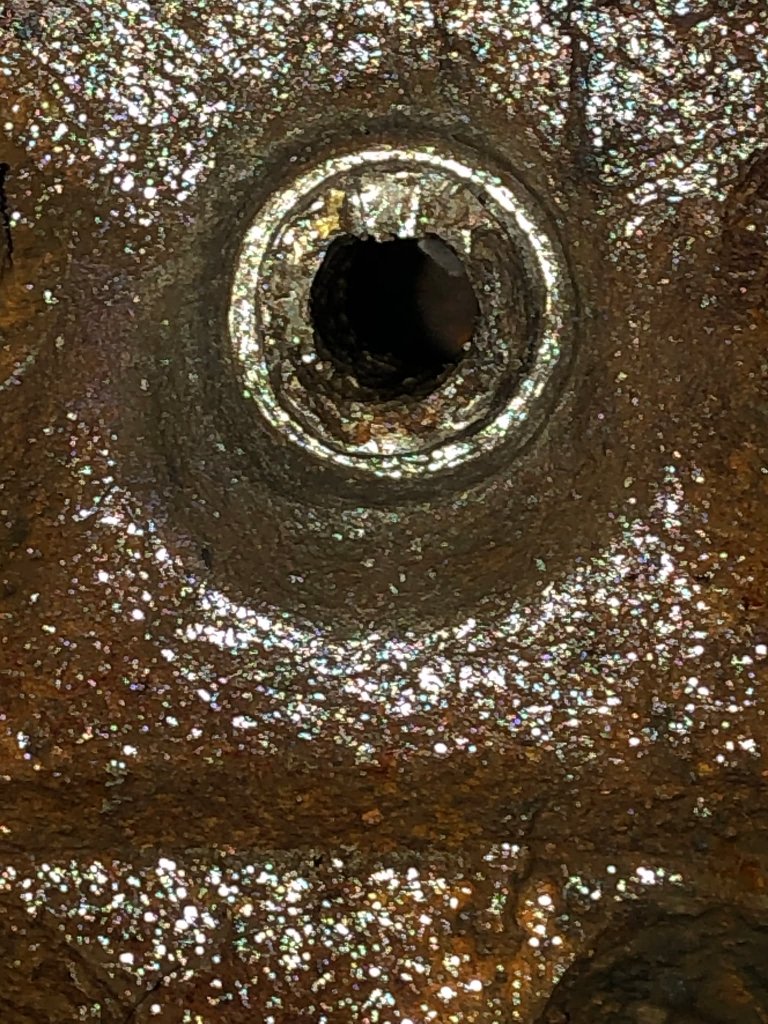

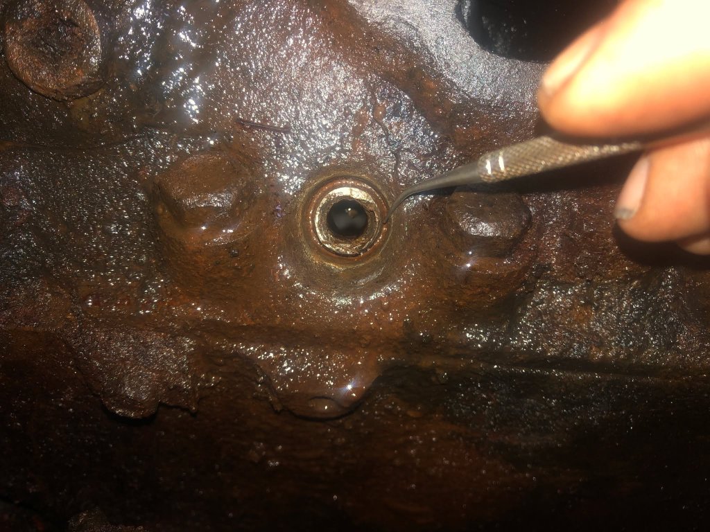

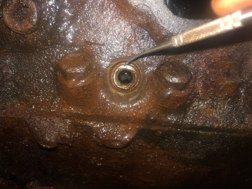

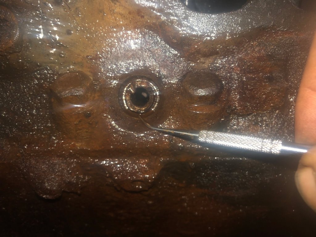

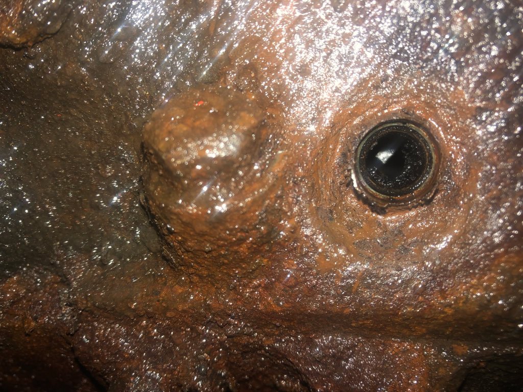

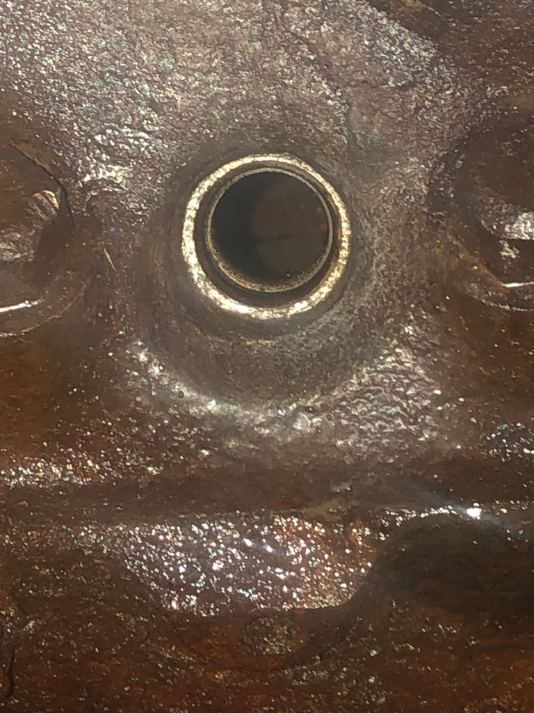

Had to get in a with vinegar and a pick to clean out all the rust around the casing. I hit it with heat on a propane torch and hit it with deep creep but still not budging. Got it soaking overnight in deep creep and will see if hitting it with heat again may let it bust loose.

Personally I'd give up on the easy out,and this will buy you some time also,while the deep creep soaks in. Buy a tap for the plug hole,also buy a left hand drill bit,in correct tap size. I'll get you the size. Drill the plug with the left hand bit sometimes,not always but sometimes the bit will bite and spin the remaining threads out. If you don't get that lucky now you are at tap size and can retap the holes. Grease your bit and your tap to collect the chips. FYI left hand bits are a real thing,not a joke I made up, they turn counter clockwise,instead of clockwise,and when you get your broke fastener drilled that thin sometimes they'll spin the remaining fastener back out. 15/32 bit.

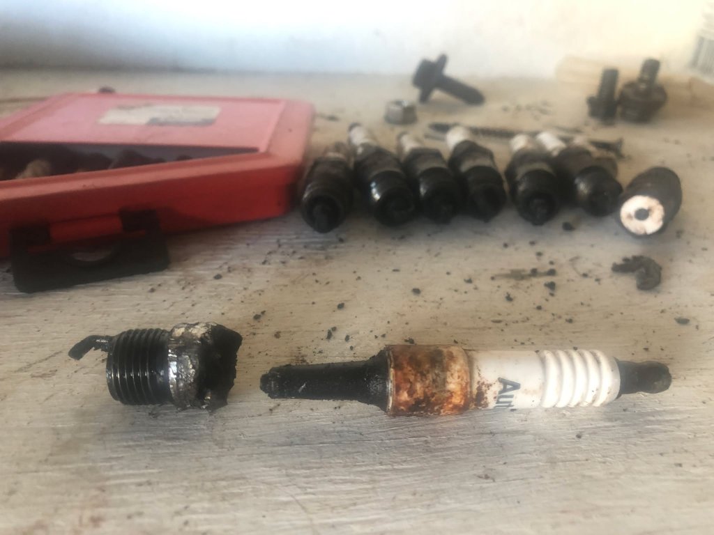

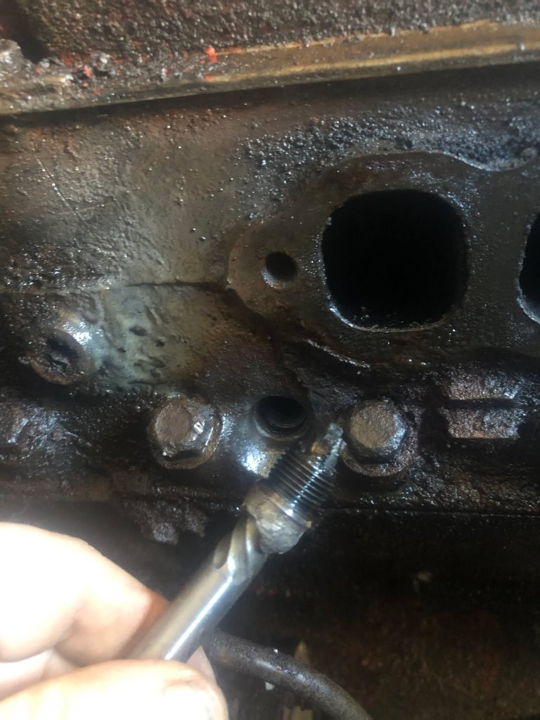

Got no spot in town to get my oxygen and acetylene bottles filled,have to order left hand drill bits big enough for this,so in the meantime of waiting,I tried what we did years back with as much heat as I could throw at it with a propane torch and $1.49 of birthday candles I threw at it,the wax got enough into the threads to break free easy with my cheap exractor with a cresent wrench. I had to clean an inch of rust out of the channels and tried propane for days with pb blaster and deep creep then vinegar to get it enough space to let that wax down in there. I had to be patient using a pick to scrape out that thick rust but in the end wax won the day to break it free.
Hell yeah!
Proper heat and lube. 95% of the time it works. The 5% it doesn't is usually because it was over torqued before it rusted in place, or there was never a chance at all.
