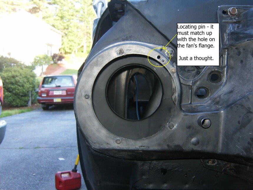

Did you have it indexed correctly? There is a locating pin on the housing that must line up with the hole on the fan mounting flange. If you were one screw off (either CW or CCW) the fan would be cocked and not center in the hole through the firewall.
When you tightened it up - maybe you bent the shaft (or the fan blading) enough to cause it to seize?
I am not explaining this well - maybe this will help:
