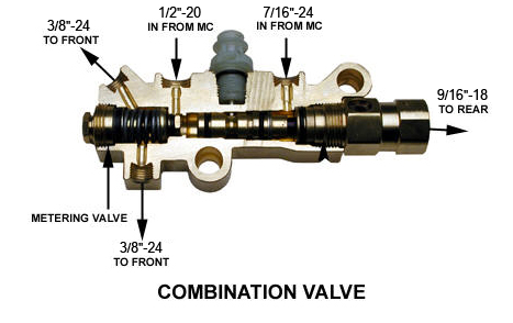

Here is an image of the proportioning valve showing the sizes of the connections and where they come from/ go to.
