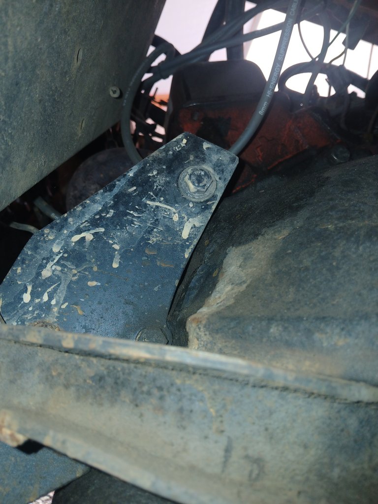

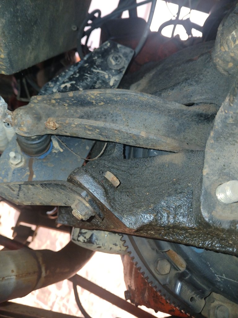

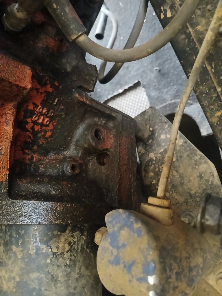

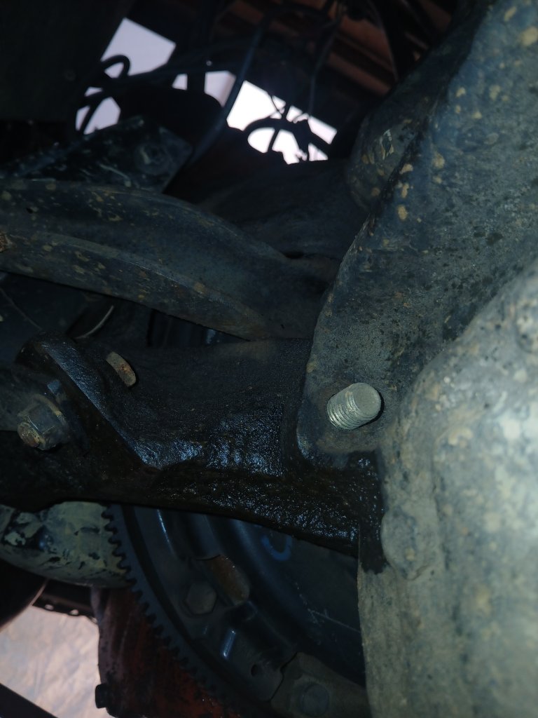

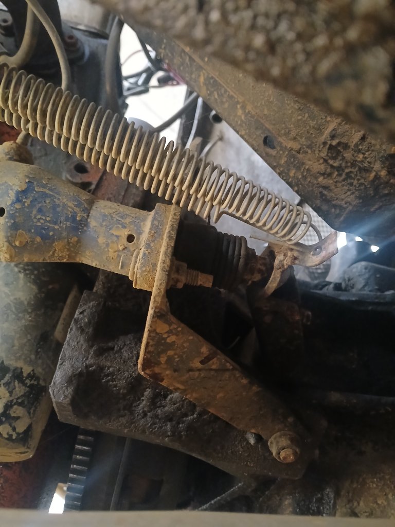

Could a guy modify the linkage pedal for hydraulic and have master under floor with remote reservoir on firewall? Maybe I should dig out my hydraulic and mechanical pedals and look at them side by side for comparison.
I did this on a mechanical bell housing to use hydraulic with it.
