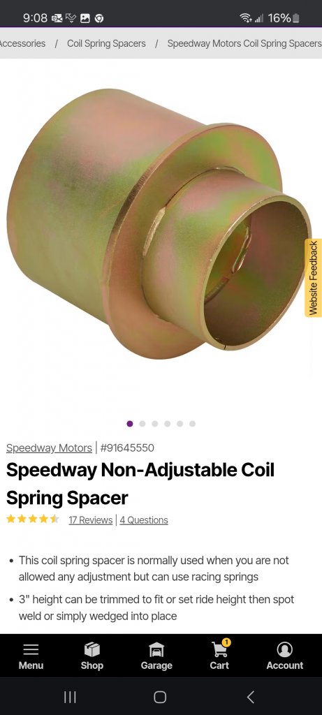

Coil over shocks are not (AKA Struts) yes you could add Coil overs and gain some height,I'm assuming you are working on a c10 it would be cheaper and easier to add spacers to your existing springs. Any circle track supply place will have them,I'd assume Jegs,Speedway and Summit also. Adding spacers spacer thickness x 2 is your approximate lift. Try searching random truck kid c1oh he lifted his C10 ,6 inches with springs and spindles.
