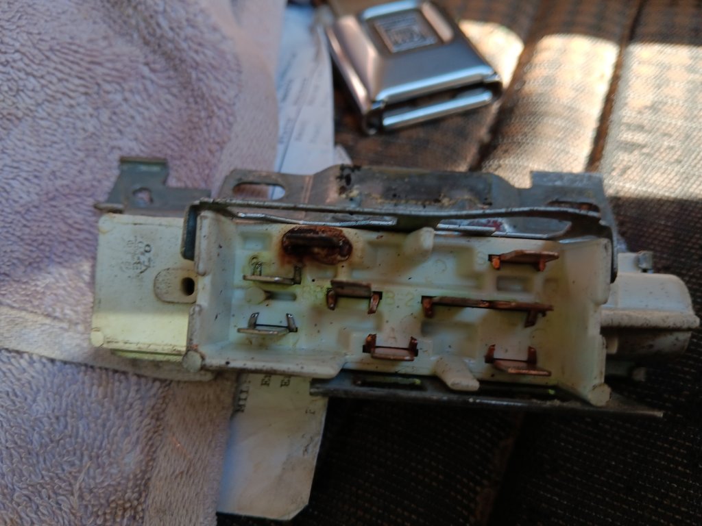

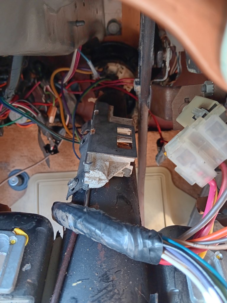

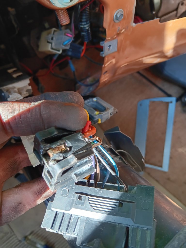

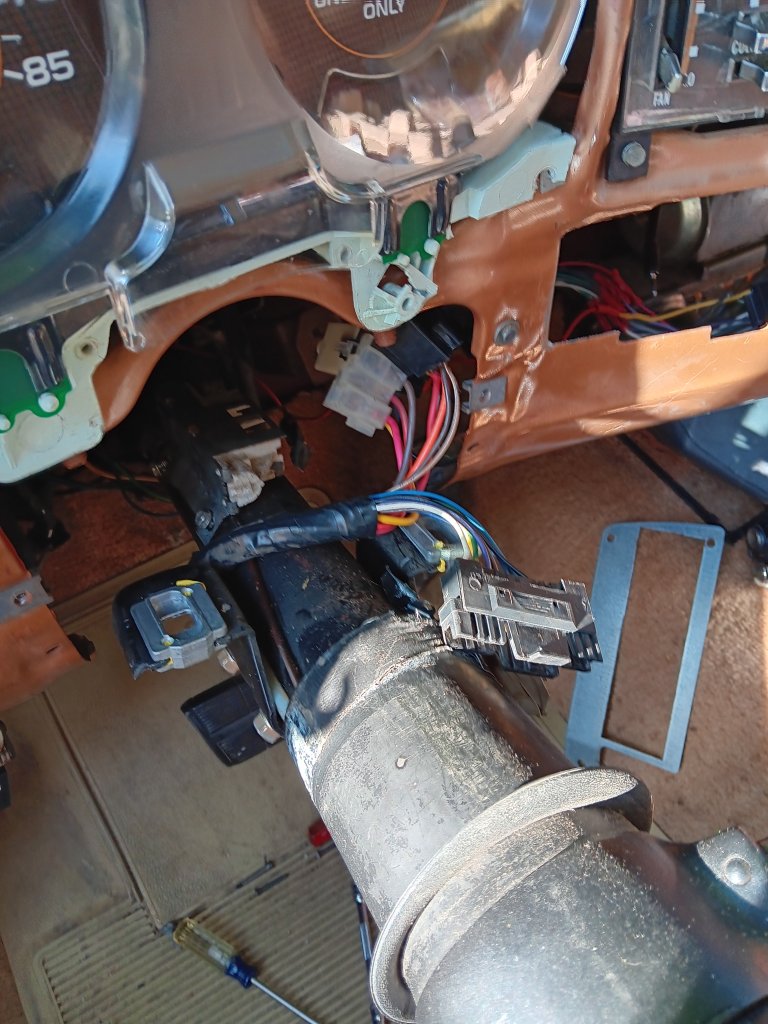

I had an intermittent blower issue develop suddenly and swore it was the blower switch. Found this burned ignition switch contact to really be the culprit. Accidentally wiggled a wire while pulling the dash is how I caught this.
I have factory rear air and suspect this terminal has to do with energizing both blowers.
Good Luck in your search !

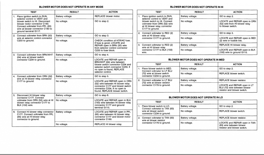

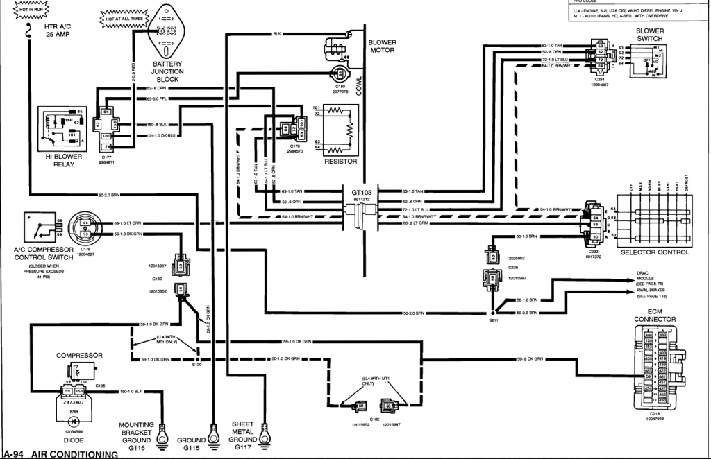

FWIW your blower has 2 power sources I for lower speeds through the resistor a seperate for high speed,I believe that's the one that goes through the relay. The switch controls power to the resistor and signal to the relay. I'd test my new relay and check pin out. If it checks good I'd be looking at power to and through the switch.

I had the blower motor resistor cause me intermittent blower issues last summer. first on high only, and then on other speeds. i had power at the resistor. it was intermittent and i could wiggle the resistor around and it would work sometimes. even when the high speed is connected, i think the trigger for high speed relay still goes through the resistor harness. I got a replacement from Rock Auto (might have been four seasons, I couldn't find a AC Delco at the time). all good after that.
