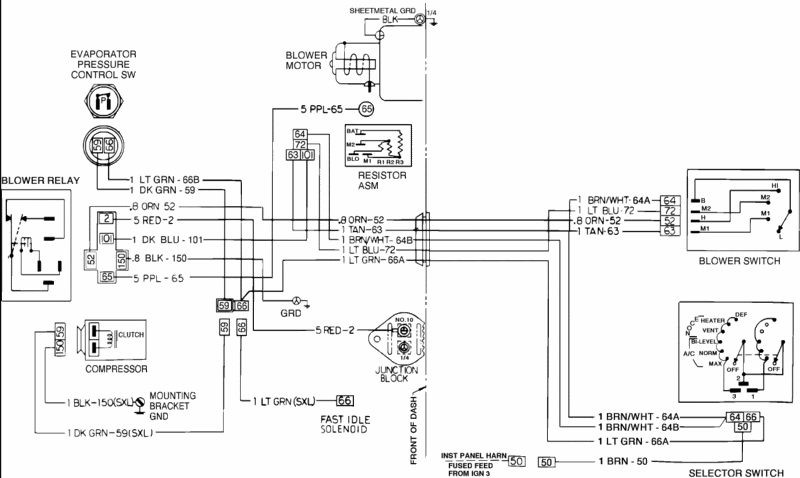

You need to start with your blower motor. All the noise is the failed bearing(s)
