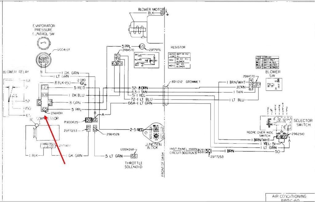

As Ricko1966 explained, the lower speeds go through the resistor pack and the fuse in the fuse panel, but high speed uses the blower relay, and it’s powered through a separate fuse and power feed. You need to troubleshoot high speed and lower speeds separately.
To troubleshoot high speed you need to put the dash switch on max speed and figure out why the relay does not turn the blower on. For the lower speeds you may need to look at the plug in the back of the dash switch and flow the wiring.

Dark blue wire at relay will have the power for the lower blower speeds and it will go to the blower by the purple wire. When you switch to high speed, orange wire will power relay to switch from dark blue wire to red wire to to go through the purple wire to blower. See attachment:
