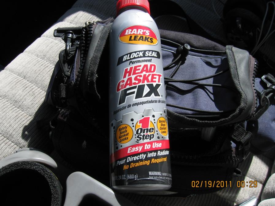

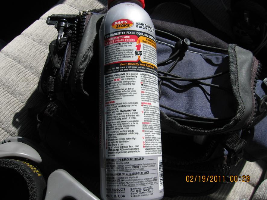

So what is this stuff called? Where did you get it? Got a pic of the bottle or can???
24,922
7,066
Bars Leaks Head Gasket Fix. **** is a life saver. I'm still pumped up about it. There is a good read on the last paragraph on this web page. :High 5:

This stuff looks is real thick and looks copper colored.
