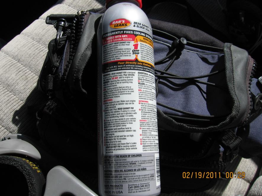

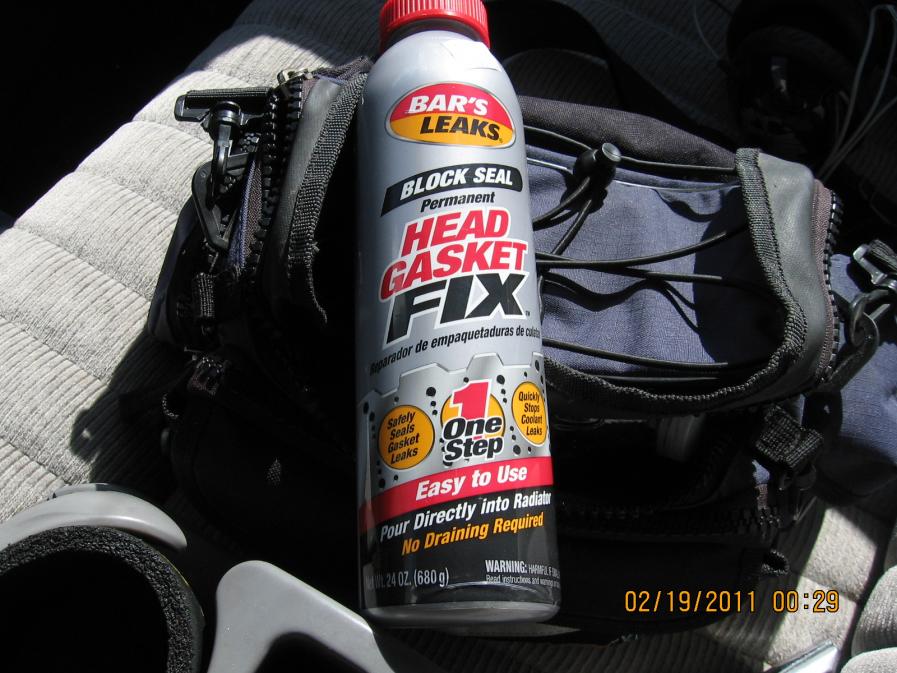

Ok, I am taking the plunge and gonna try this ****.

Be sure to follow the directions EXACTLY as it says to do. If it says pour it in a cold motor, make sure its cold. If it say to drive 2000 miles after pouring it in, you better get a full tank of gas first and a few cans. Just saying, do it exactly as it says to do it and don't waiver a bit.

Way to go man! It says permanent...

Which BTW 89s, If It were me, and I really wanted to give that stuff a try, I think I'd pull my thermostat out for a few days. Reason being, you want to keep the stuff circulating at all times and not let it stop. This way as it circulates, it should find any leaks and fill them. I'd be afraid if it stopped circulating, thats when it would clog stuff like radiator or heater core. Just a suggestion, I don't know if it would make a difference for sure or not.
24,922
7,066
Ok, I put this **** in after I installed the water pump and it worked outstanding. Now more ****** smelly white smoke out of the tailpipe or puddle below the tail pipe when sitting at an idle, huge ass difference. It works fast as **** too. Worth every bit of that $40 bucks. We will see how long it lasts, but it gives me some breathing room and time to get a replacement motor or get things gathered for doing a head gasket job.
I am a totally different person this week not stressing over burning coolant issue. I am a very happy camper and back this product 100%. :High 5:
