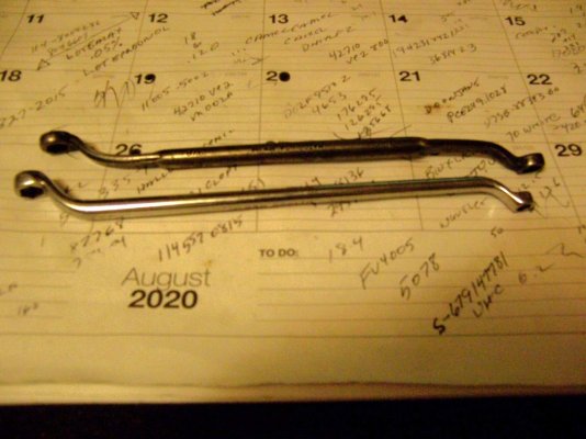

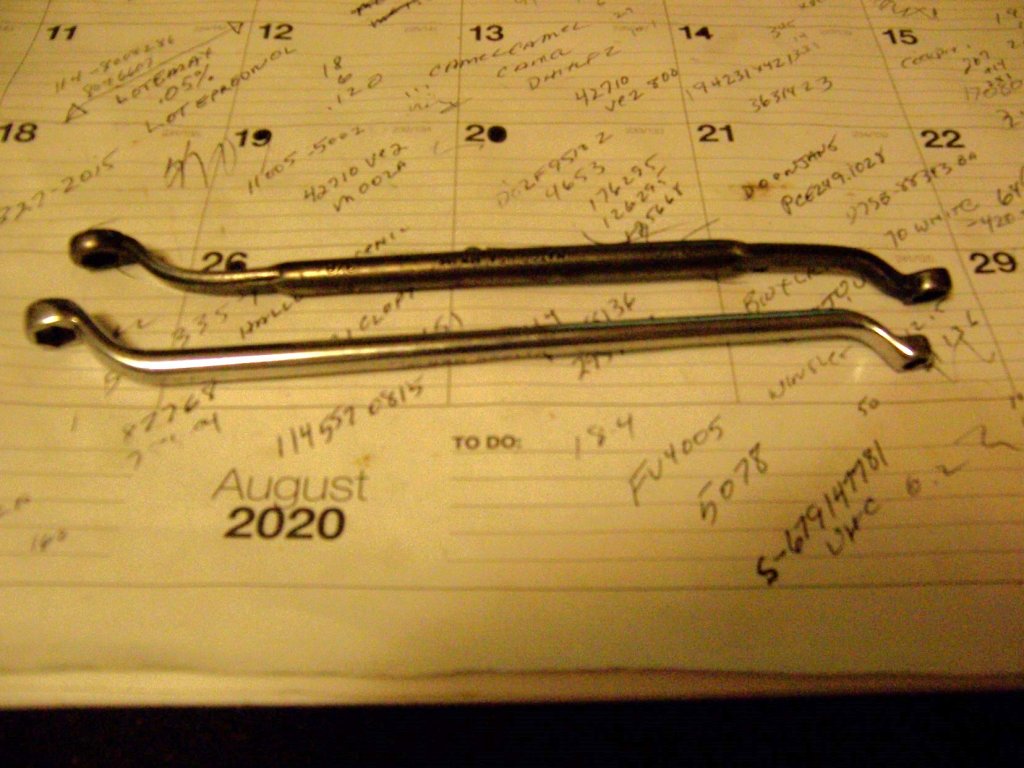

I was out in the garage and remembered about this bleeder wrench thing. Pictured here is my snap-on bleeder wrench that I use most often and also my specialty wrench that I can't remember the maker (red handle).
And here I am trying to use both of them on my cab/chassis truck. Please note, I pictured the side with a broken and missing u-bolt... this pretty much doubles the access space, but I did it for picture clarity. The specialty bleeder wrench fits right in and would clear the u-bolt if it was still there. The regular bleeder wrench though, I couldn't even get it to engage the bleeder due to clearance issues all around. And it's even taking up the space that has been vacated by the u-bolt.
I have no idea how y'all can manage to access that bleeder with a box end wrench or any type of standard bleeder wrench.

those are great photos
I've looked on line with and the wait for shipping is too far out. So I hope I can make my own
Would it be possible to get a picture showing the dimension of the offset looks like about 1 1/2"

Well crap, I forgot about this. Probably too late now, but here's some basic dimensions.

No this is perfect, been so busy with other things I have yet to try to build it. I really appreciate the time you took to get me the info.
