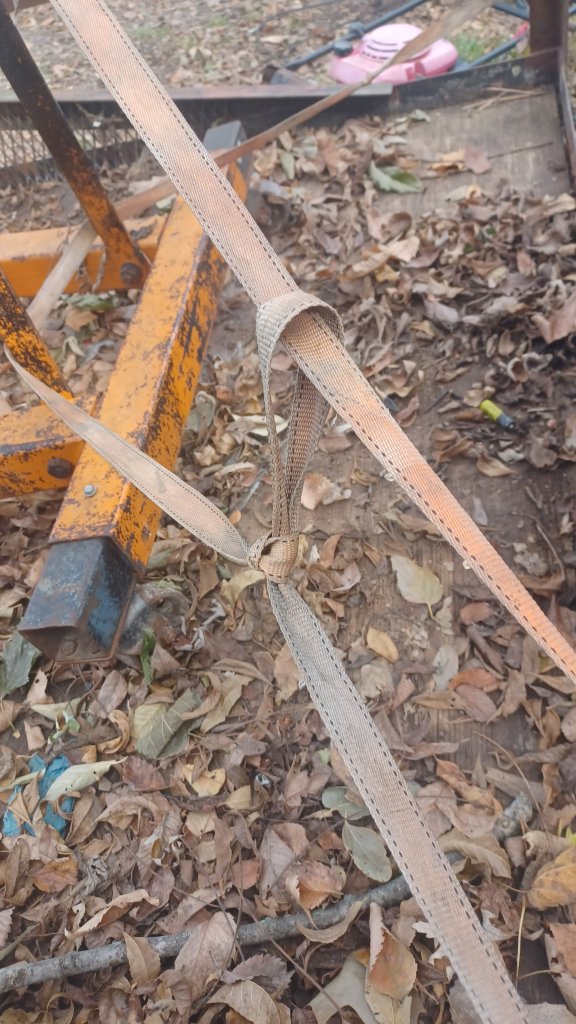

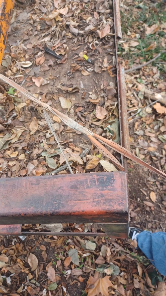

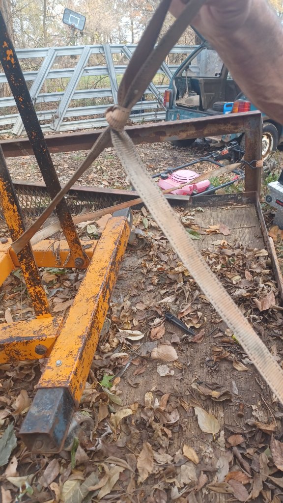

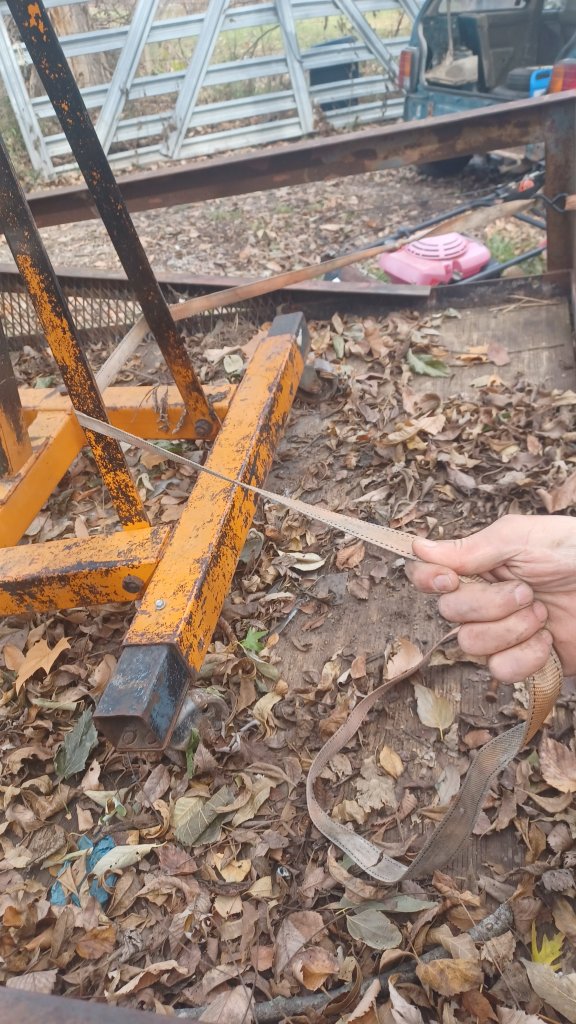

I'll do the math in a minute got you a link to a hay hauler hitch, I don't tie it off the same I pull the tail back to a secure point and tie the tail to some thing to maintain tension.But you'll get the idea. Check back I'll put up some pics I shot for a buddy once to tech him when I find them . Here's the video link. I'll crunch your math brb.https://youtube.com/shorts/zvUB6AGWHQ0?feature=shared
