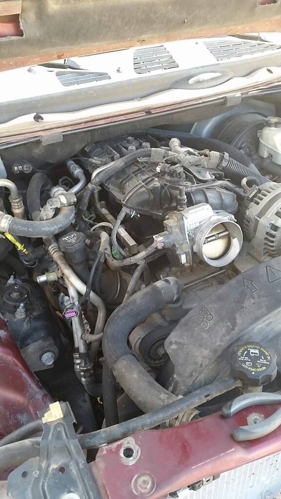

Bad new started to take the spark plugs out of the lh6 to see if she would turn over and found a melted spark plug and the motor still wouldn't turn over! What should I do?

That is going to require a teardown unfortunately. A melted plug could mean internal damage to pistons or possible detonation problems.

I figured that. Well the thing is it back fired like a mother before it finally lock! I thinking it might have head gasket problems to because there little bit of water and the oil and I know it's got hot a time or two. Do these heads warp easy?

Aluminum plus high temperatures is never a good combination.
You will need to straight edge the block and such to check for any warpage.

Damn, I have only seen that one other time in my life. It very well could have just been a bad plug. How old were they? Doesn't really matter, your going to have to pull the motor apart, and find the missing pieces of the plug.
The one other time I have seen something like that, my buddy was racing and way over revved the motor, to almost 10 grand, the only thing we could come up with, it the piston hit the plug, and shattered the electrode, we tore it apart and found a bunch of spark plug in the cylinders.

This one is like melted tho looks like the end of tungsten rod

One of 2 things, either a defective plug, or extremely hot combustion chamber temperature. How do the other plugs look?
