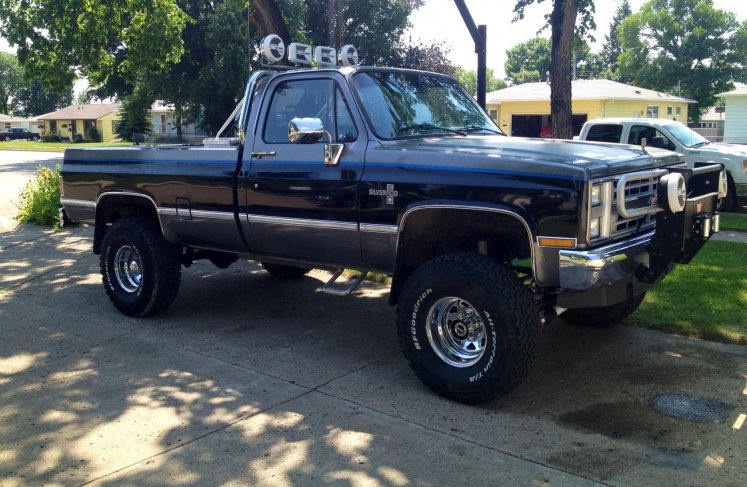

Ok, other than too many cinder block orientation comments (blocks were changed shortly after taking pic due to realizing they were placed incorrectly)...the job is done.
Steering creaked constantly and was hard to control when I hit any bump.....removed driver tire, drive shaft and housing...new upper & lower ball joints...problem solved.
Leaking fluid from front differential....pinion seal bad. Replaced that today too.
Tightened steering box gearing....drives like a different truck!
4" rough country had to be added to clear tires after this pic was taken....toooooo much rubbing otherwise!

With 4" RC lift, but from the ride im experiencing...im thinkin i chose the wrong lift company....very rough/bouncy...my wife now hates riding in my truck cause its so bad....no clue what to do about that....
