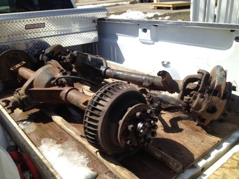

Axles as received

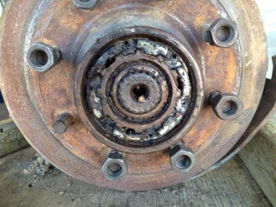

Ya...for real...lots of scraping!

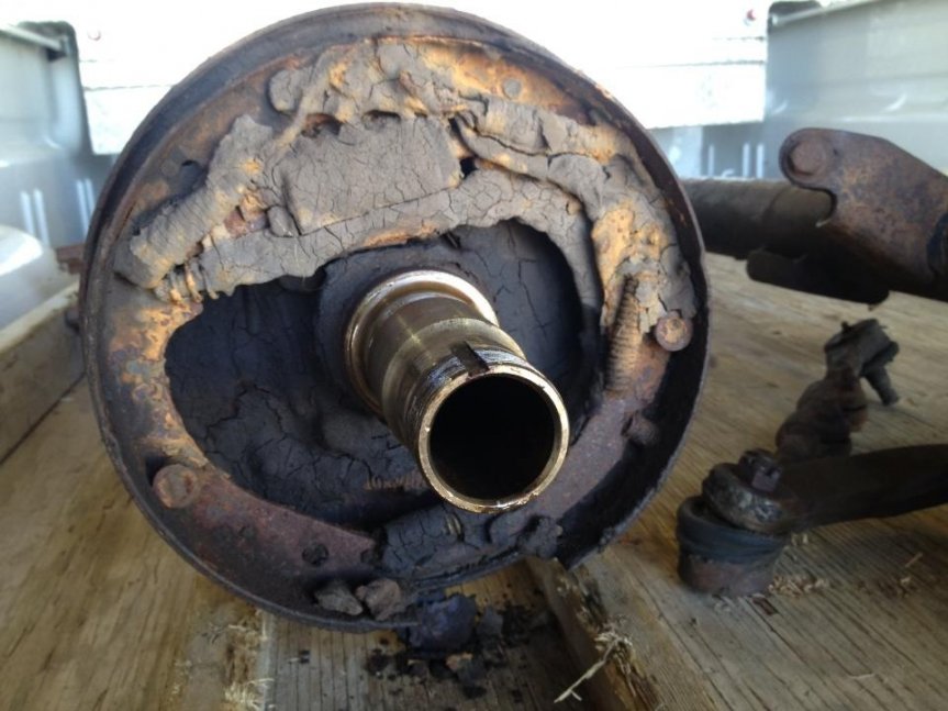

No bueno! Add new lockouts to the list.

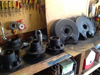

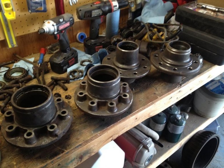

Wire wheel on a grinder and dust mask/protective glasses....and patience....all dust shields, rotors, hubs and axles are rust free ready to be wiped down with parts cleaner and primed.
Hubs are getting new races, bearings and seals pressed in at machine shop.

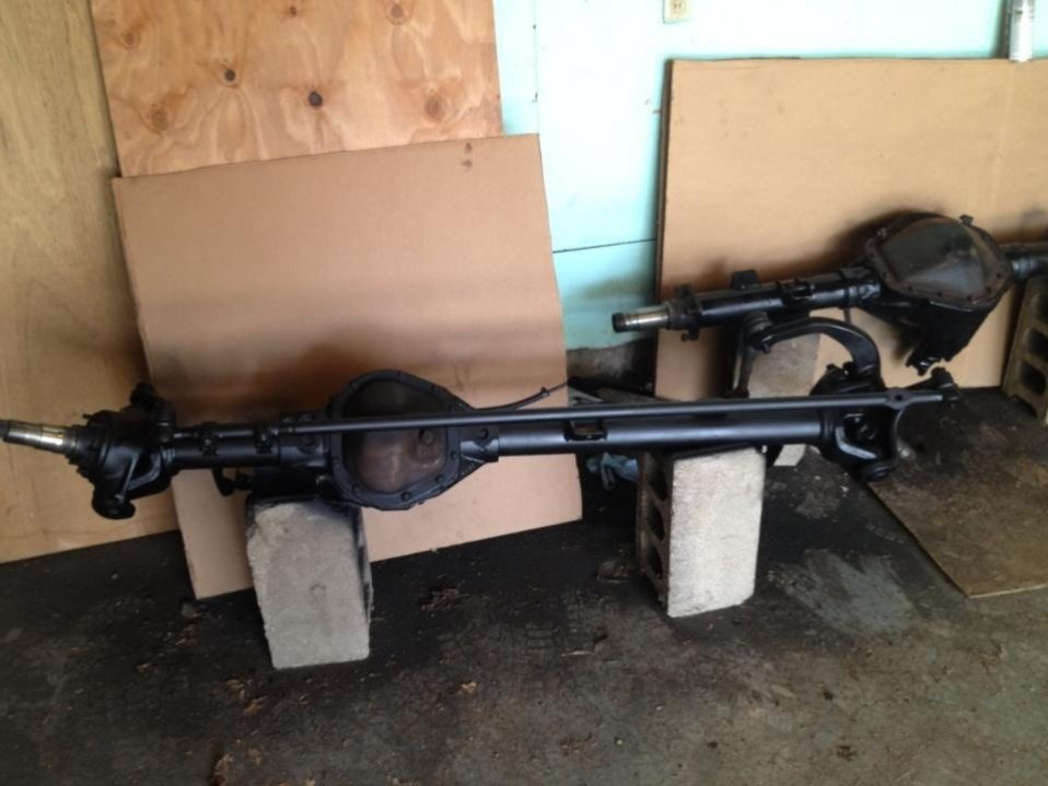

Everyone primed and painted with engine paint.

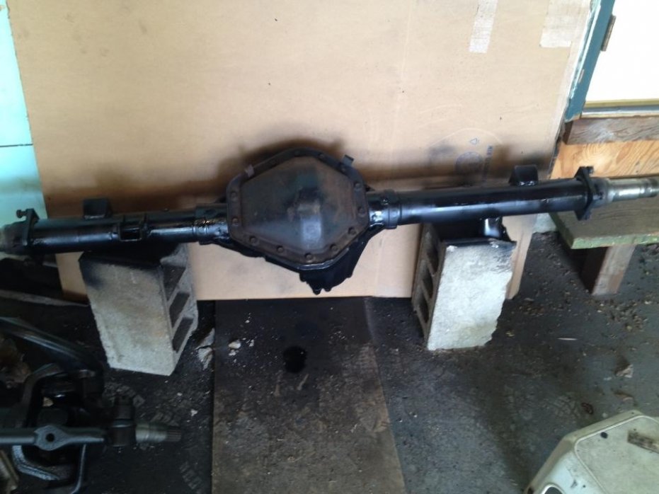

Painted Corp 14...same story with diff cover.
Waiting on finished hubs, new lockouts, new drums, turned rotors, lug studs, new calipers, new drum brakes...then reassembly!
