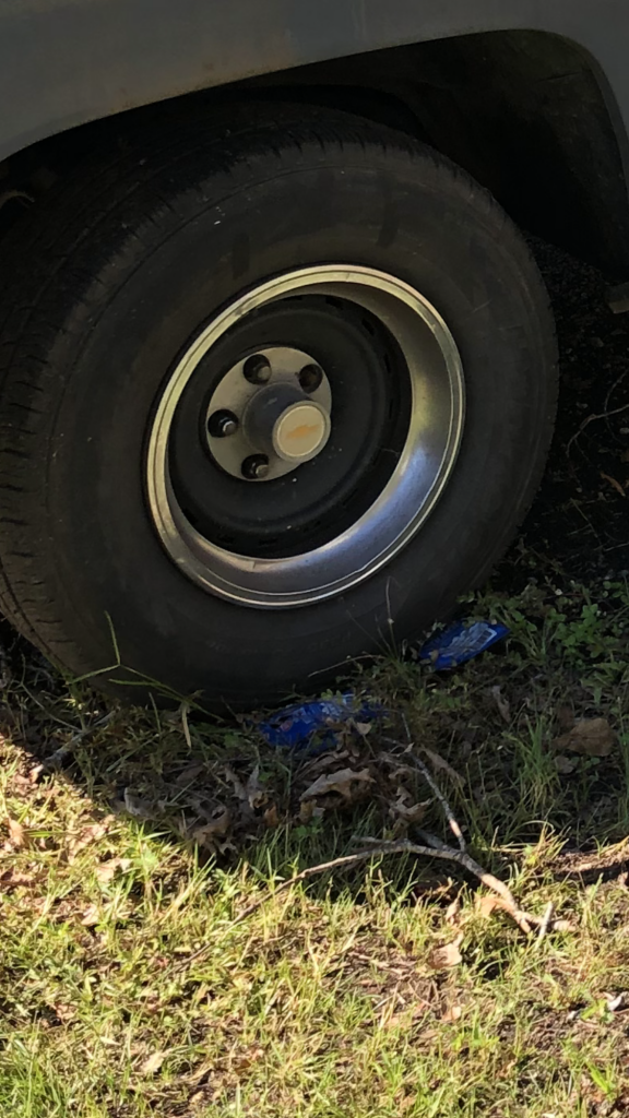

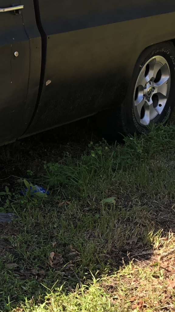

I have a question. I have a 77 C10 and the front axle shaft sticks out further than the back. I was putting rims on it but they won’t go over the shaft in the front cause it pokes out like 3-4 inches and if I could the rim with sat out further in the front then the back ones. Is there a way to fix this issue? I’ve included pics of the front and back. The part that pokes out with Chevy symbol is the front. Initially I thought that was just a cap for the rim but when I took it off it’s actually a cover for the axle shaft.

Your C10 doesn't really have a front axle shaft. The wheel/rotor ride on a spindle. The center cap on your front wheel hides the wheel bearing cap. If your new wheels don't fit on the front, you need to remove the center cap from them. Either run them without the center cap (which is ugly to some), or buy some new center caps if they're available. I can't tell from the picture what the rear wheels are, so IDK if aftermarket center caps are available.
31,892
32,686
Judging by the picture showing the modern factory wheel of some kind, you have two options. Either hog out the center bore of the rim to fit over the front bearing hub, or run wheel spacers.
