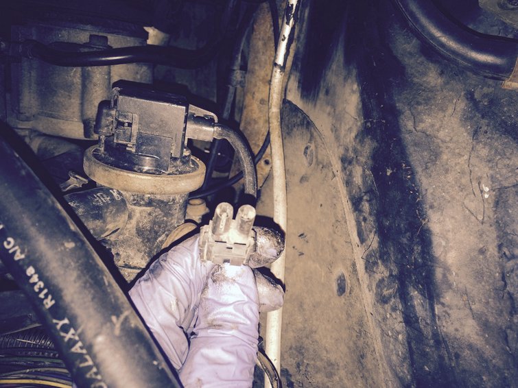

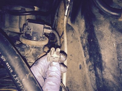

That looks like it should plug into one of the A.I.R. valves, I believe that is one one right behind your hand.
Being able to pull on the wiring and engage the compressor sounds like when the main HVAC connector was melting on my car, and the repair we discussed off line.
You were right! Plugged straight into the diverter valve. I don't know how I missed it. I don't know why it would still be that connector. I fixed it several days ago, and it all works great now.

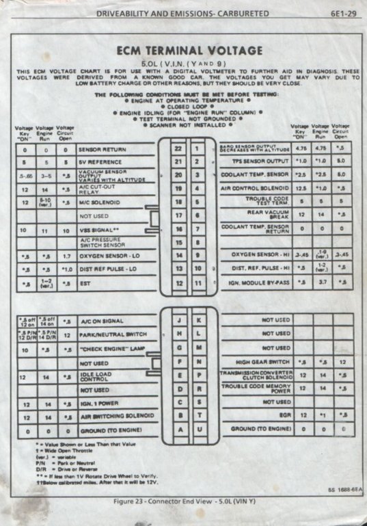

It's saying 14.6 at idle now. Both at the terminal on the alternator and the battery. I tested my dad's truck the same way, and it was saying 14.6, and the voltmeter on my mom's car is saying about 13.8. I don't know where to really go from here with the alternator. If the voltage is acceptable, I guess I'll have to go through and check the harness pin by pin. I found an ECM voltage diagram for an Olds 307 with CCC, but I imagine it's exactly the same. There's very little literature available for this system. I also noticed that my warning lights aren't working as of a few days ago when I turn the key to on like before. I'd see a choke light, a parking brake light, and a battery light do a little self-test thing. The ECM light is staying on, but I don't have one in it right now so that's why. When I turn it to start, they'll flicker like normal, but the warning lights are dead when the key's on, and the engine's off. Could there be something going on with my ignition switch? I checked the fuses, and they're good, and I watched my choke, and it's working fine. I also checked to see how much voltage the ECM was getting straight off the harness pin. It's saying 10.75 key on, engine off, and it's supposed to be 12, and it's getting 12.1 key on, engine on, and the chart says it's supposed to get 14. My ECM ground is right there sticking up off the top of the floor pan, and I'll double check that, but I think it looks good so I'm not sure...
