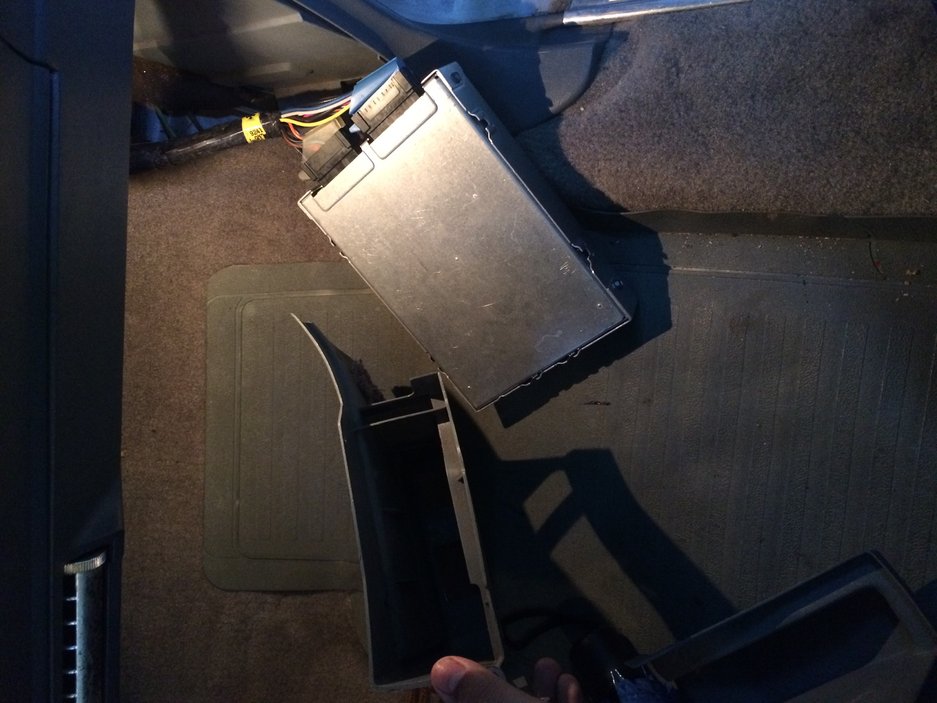

Keeps messing up! Each one lasts longer than the previous one, but this makes three that I've gone through since the storm. This last one worked fine for a week, and I was very careful with it to minimize exposure to static electricity or anything that may even remotely hurt it. I don't know what the problem is. Last night I finished soldering up the TCC solenoid connector that had been chewed up by a rat, and repairing where the insulation had been gnawed on so nothing would short out. I ran it around, and about thirty minutes later, it started shuddering and pinging under load. Checked back today, and the ECM's burned (again). Here's a picture showing where the ECM is located and the hole inside the kick panel where it slides into.

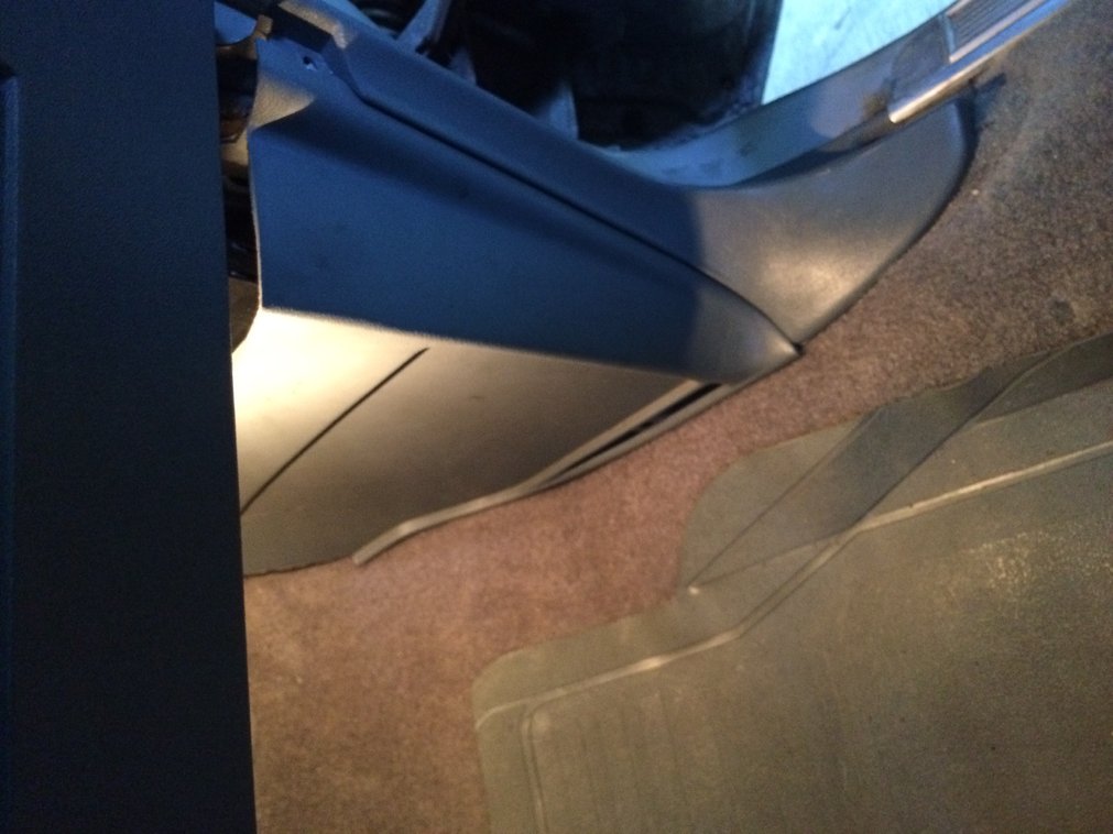

Here's how it normally lives when it's not being a POS.
