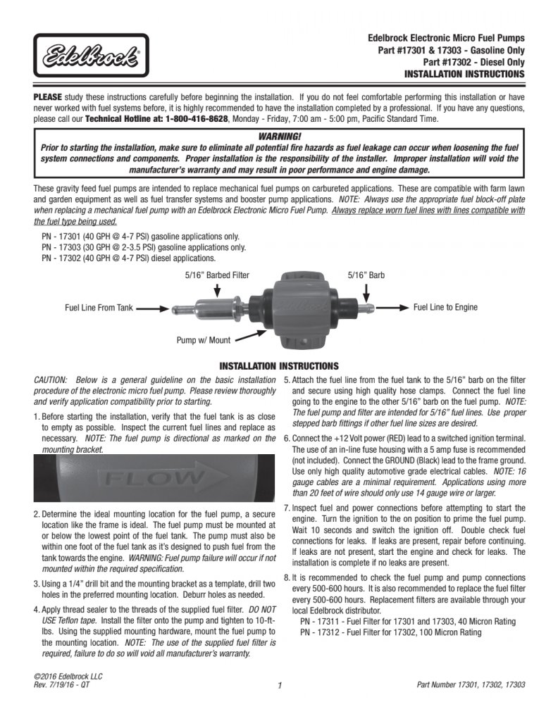

While I would advocate for the mechanical like mentioned earlier. Here is the instruction guide for one of these style pumps if you are firm set on running one. This paper I assume would be in your packaging also.
thanks man, came with the pump
