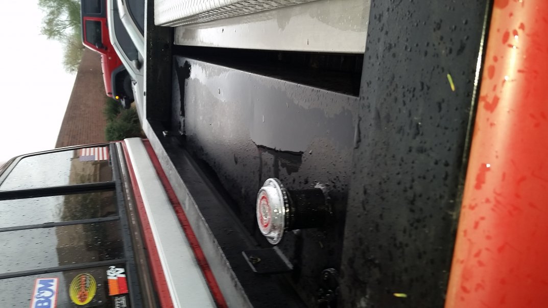

I took my saddle tanks out and had a 50 gal tank made for the bed. Works great, minus the smaller bed area.
Got any pics of your setup!?

Here ya go this ones mine
