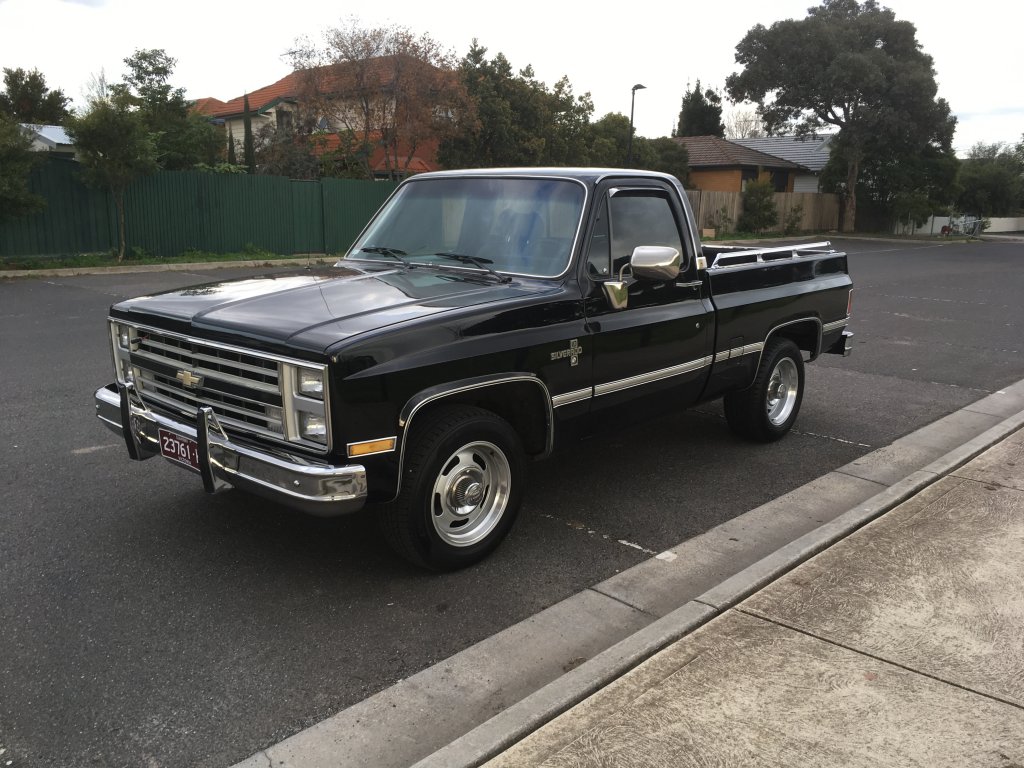

WTF ? 350HO crate,performer intake manifold,long tube headers,700r4 3.5 gears in a ford 9 inch,rebulit Quadrajet.
Around town driving like a granny and never out of the primarys I get 16-17mpg and its never getting into OD.
As soon as I drive it hard and into the secondarys it drops to 6-7mpg. Maybe our fuel is better than yours but my bet is the Quady.

It's maybe worth pointing out that you use Imperial Gallons in Australia... which is significantly larger than US gallons(17% larger)
Interesting!I didn't know that. That makes more sense of low fuel mileage the poster is getting. I still think the quadrajet is great for economy if you drive gently.
