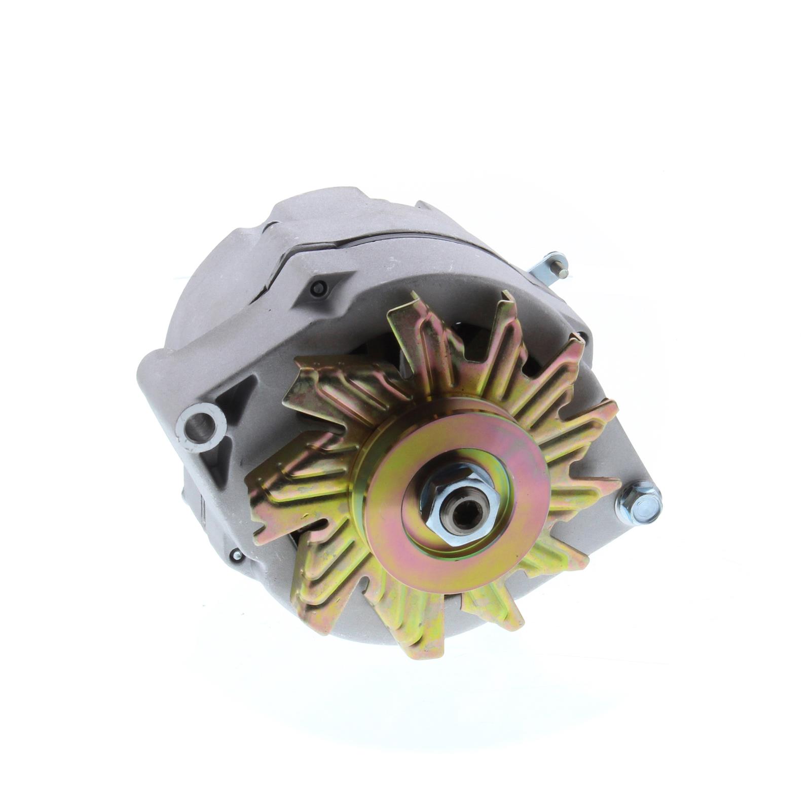

Summit has a house branded 140 amp 10si pattern alternator. Should be plenty for you. The CS130s are nice, and do go over 200 amps nowadays, but they're also more sensitive. For pure reliability, it's hard to beat a 10/12si. The one I link to is also able to be run as a one wire, so if you're stuck somewhere and need to rig it up, you can.

Well I thought this was solved, but then I looked and the alt linked was for a V belt, and mine has a 5 groove. So I check the other models, the next model number up is a SIX groove pully. *sigh*. The search continues.

You should be able to swap the pulleys with the one from your old alternator.

You can swap the serpentine pulley over to the Summit alternator.
