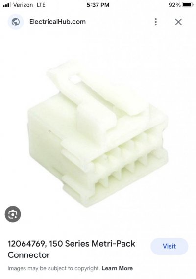

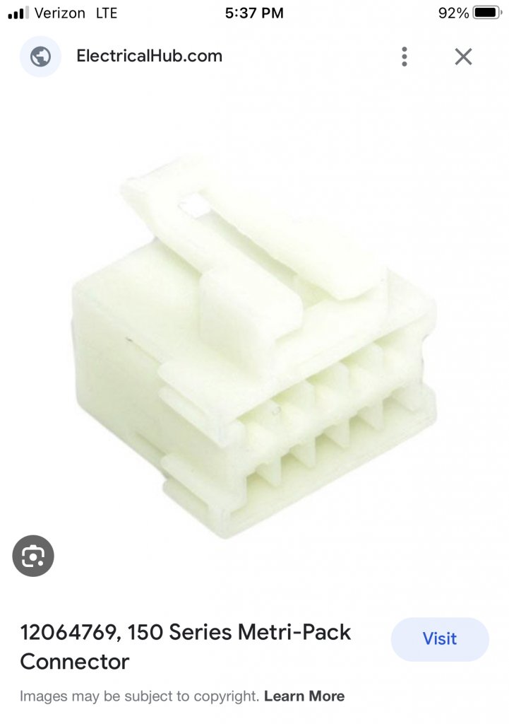

I have lots of things in my cars and trucks wired with connectors like this. If you have a Pick a Part nearby, connectors like this are cheap. The terminals do take special tools to remove, and special crimpers, but are well worth the money.

@Matt69olds,
Thanks loads! Talking about those special tools to install/remove the terminal ends in the connectors, I need to buy the whole set. The terminal ends in the plugs in my '74 are these weird hooked looking things inside the plug. It's impossible to get the end out unless you have the correct tool otherwise.

Pretty sure this is the tool kit I bought.
JRready ST5211 Pin Removal Tool KIT for Weather Pack Metri Pack Series Connector Harness terminals and Connector Crimp pin etc Electrical Connector, Tool KIT Include DRK 785084 Amp 1.5mm Removal Tool https://a.co/d/6eanl3x
I think every square body uses series 56 terminals. You can take an old pocket screwdriver to remove the male terminal, you basically bend the locking tab making the terminal narrower. Once it’s removed straighten the terminal. You will probably need to grind a pocket screwdriver to fit the female locking tab.
