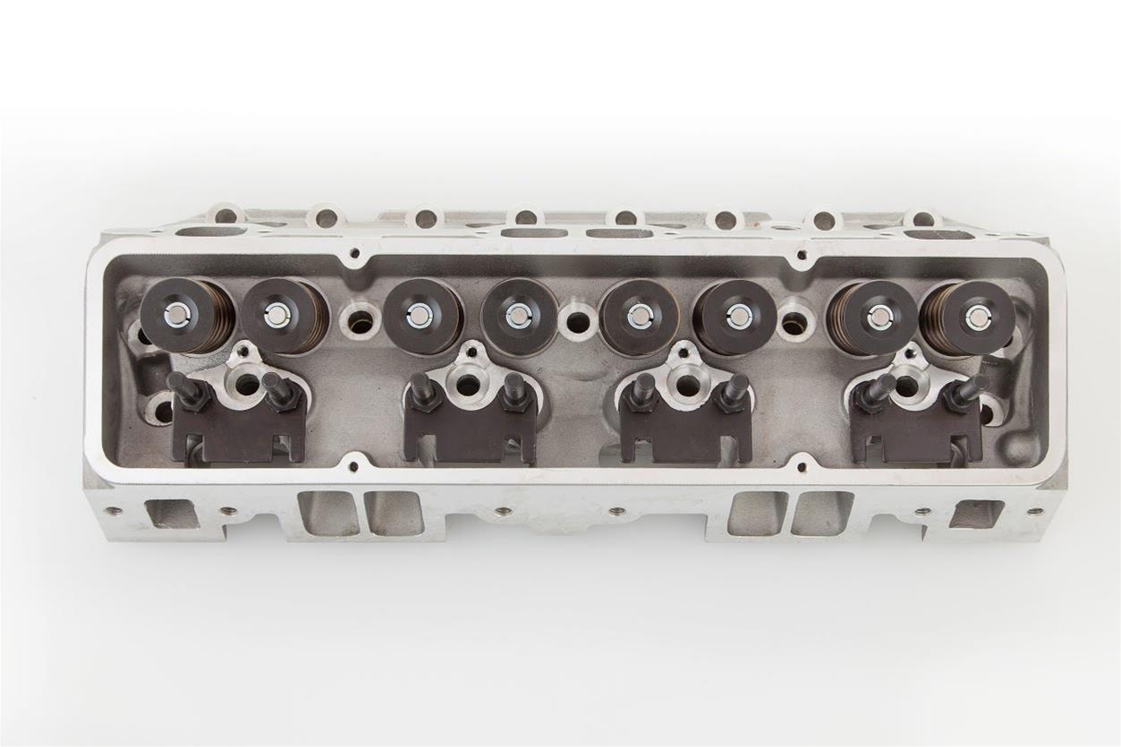

Myself I went with the aluminum flowteks for the old engine from my truck before I put the 388 in. they have a better chamber, lift, and slightly cheaper, also can just paint them if you don't want them to stand out. They have 4 different versions straight and angled plug as well as either setup for flat tappet or roller cam. just make sure you grab the correct version.

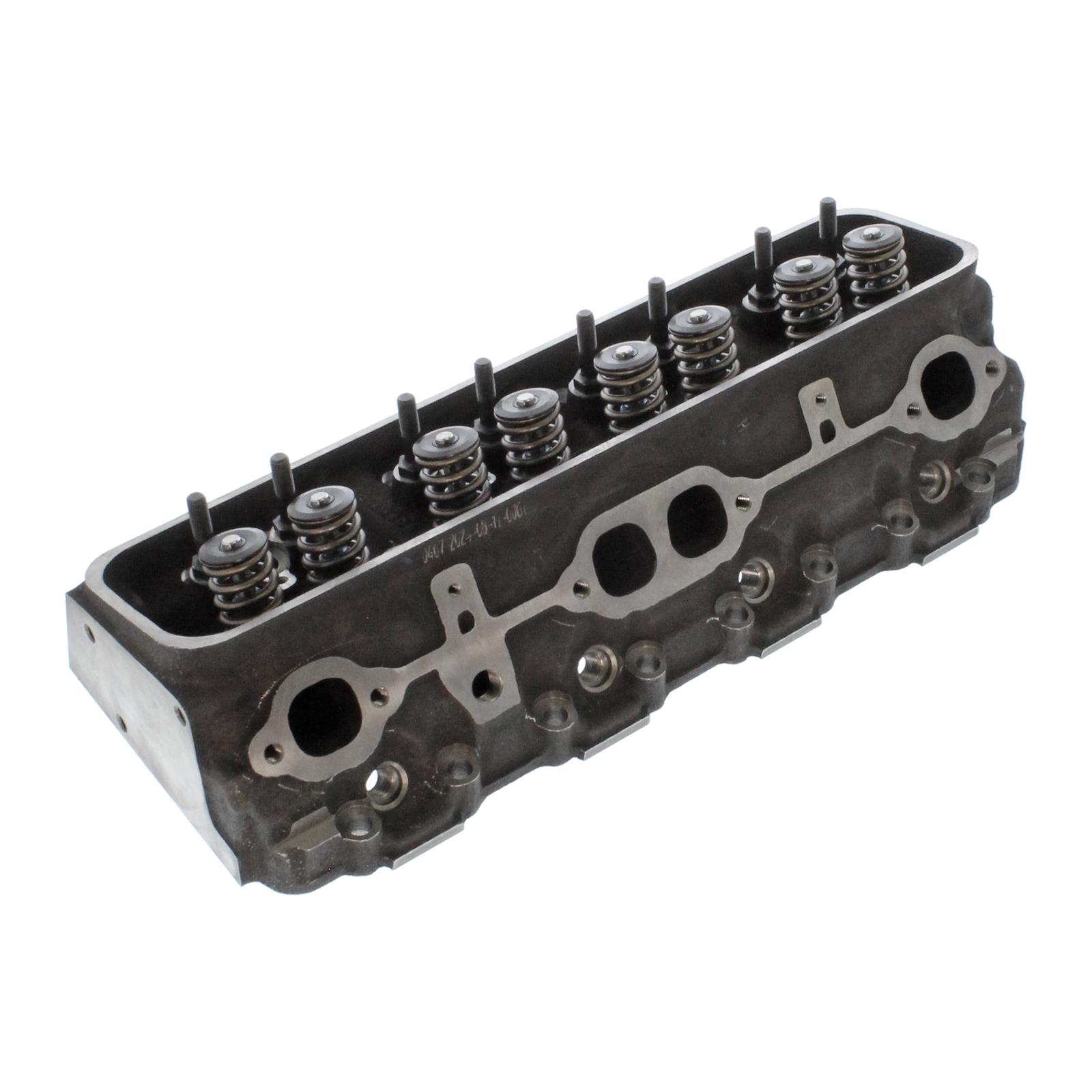

If it were me, I’d probably go the machine shop route first, especially if the heads are original and not cracked. That way you know what you’re working with. But if you go aftermarket, Jegs iron heads seem solid for a basic rebuild — I’ve seen decent reviews. Just avoid anything too “performance” if you want stock feel. Peace of mind matters either way.
