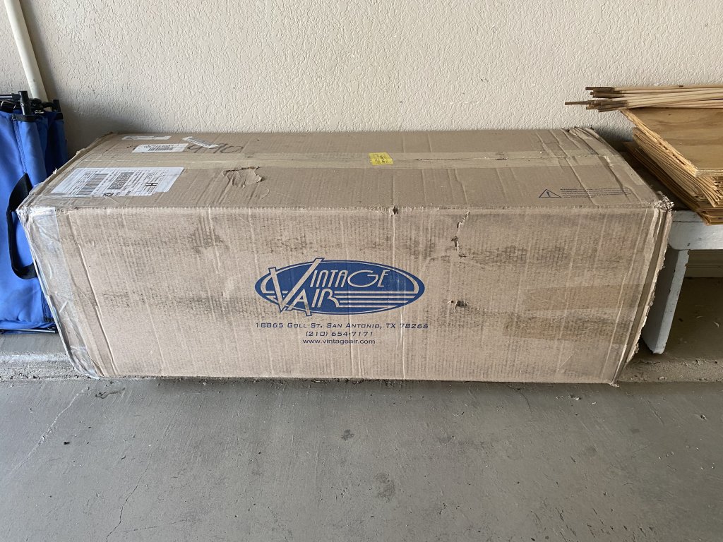

Got our Vintage Air system from Jegs with a discount code and only took 4 weeks to get, less than 1K. Hate hearing all the negative stuff about VA… hope it works here in the Texas heat! Starting on it very sooon.
Randy and Easton
