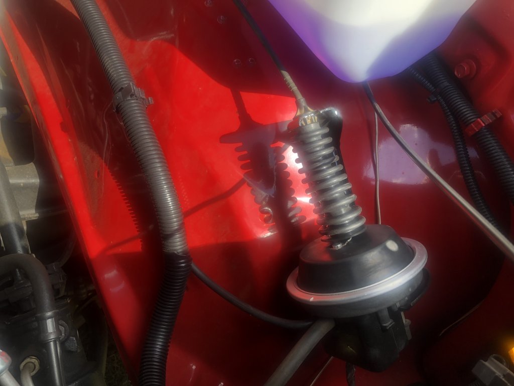

Added engine bay light and in the middle of installing the cruise control with other gm parts.

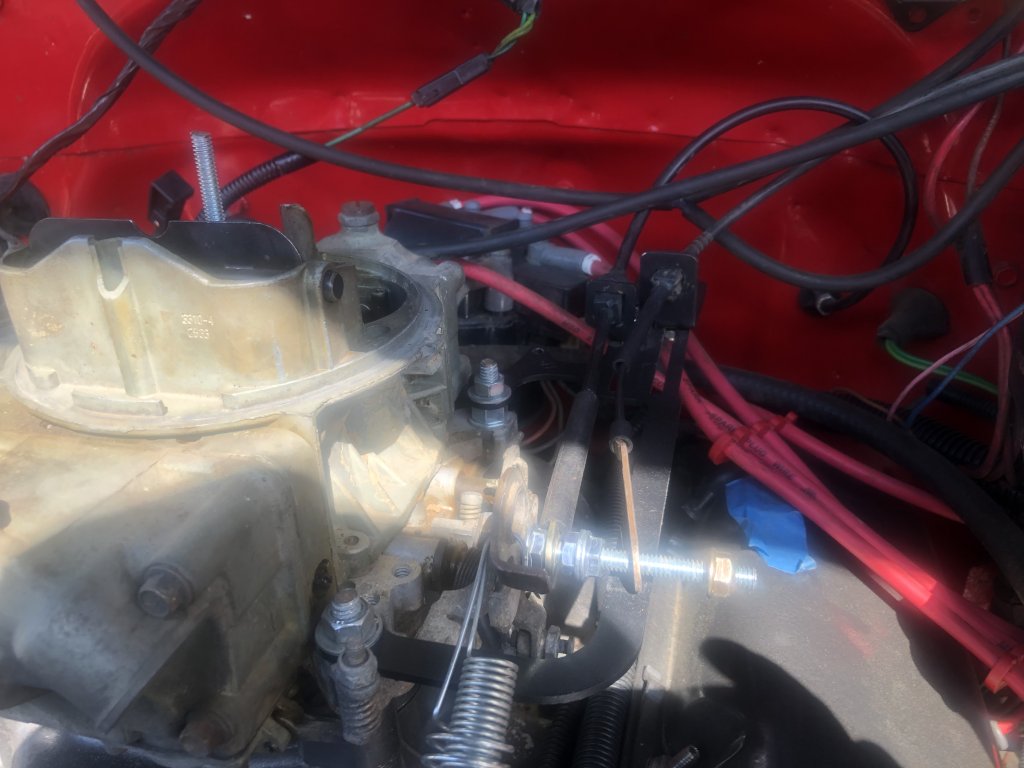

That looks new with bracket. Where did you get? Do a pic of what it looks like at carb. Our truck's was originally on intake next to the TBI. I've seen a camaro TBI with cruze on the fender well. Curious.

I bought it off of a Caprice in the junkyard several years ago cleaned it all up and painted it I had to modify the throttle bracket I got off eBay it’s a little thicker than a stock one so the cables don’t exactly snap into it

I just bought the cable boot off eBay it was listed for a 3rd gen Camaro
