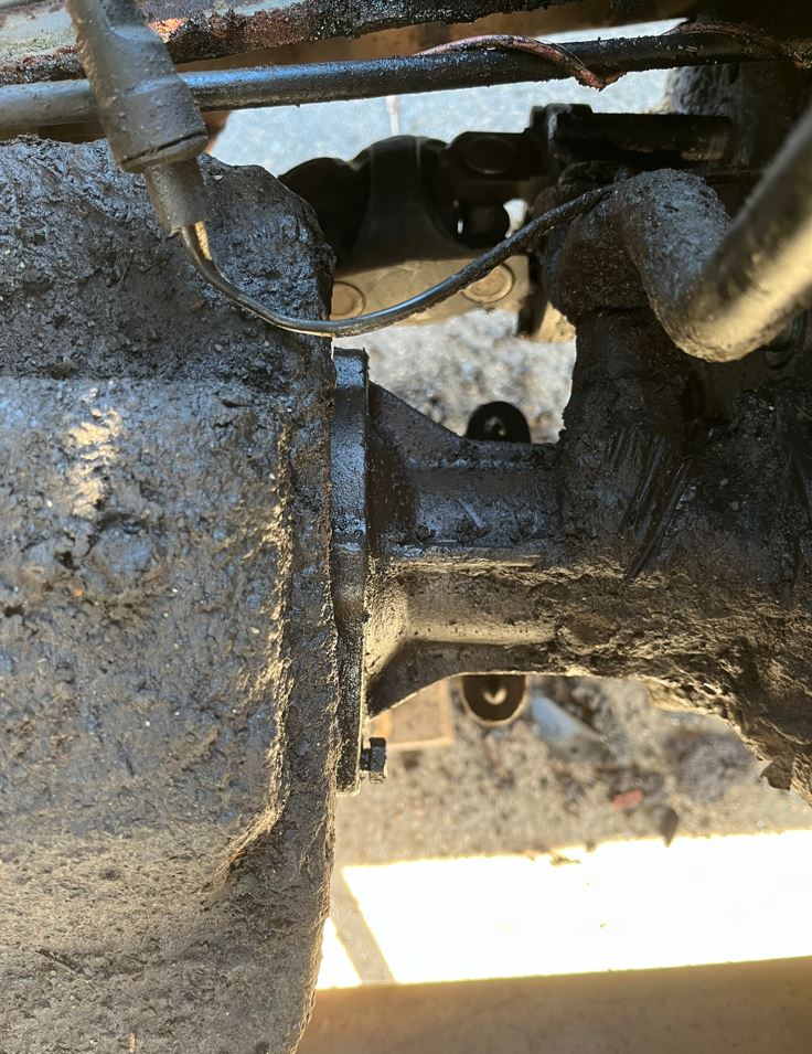

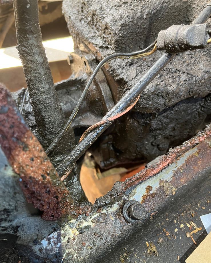

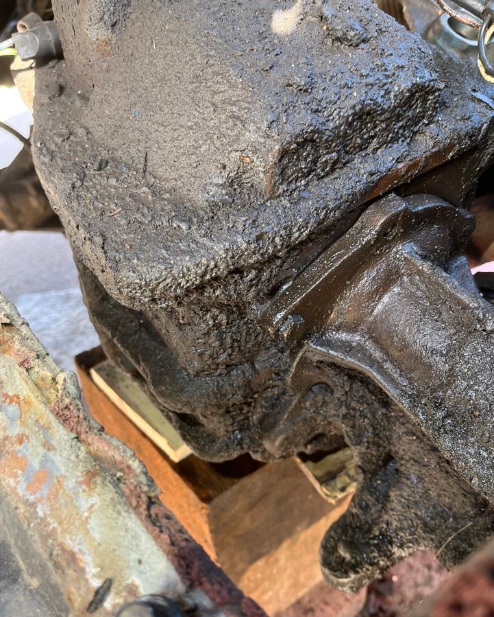

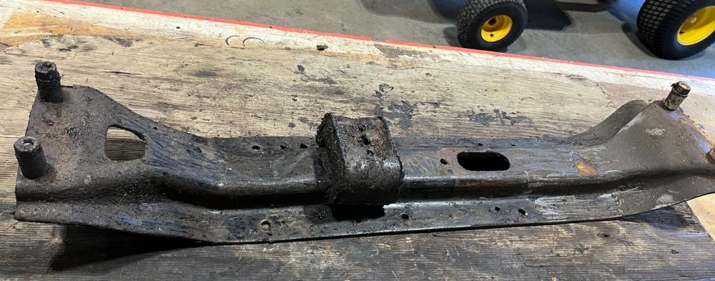

Anyway, with the bell housing off and the trans supported on a block of wood, I can stand inside the engine compartment and grab the trans and physically move the trans/transfer case by hand. I can't drop it, of course, but I mean it is not rigid, as I expected. I can play it around about an inch or two in side to side and up and down motion. Is this expected? Front and rear driveshafts still attached.

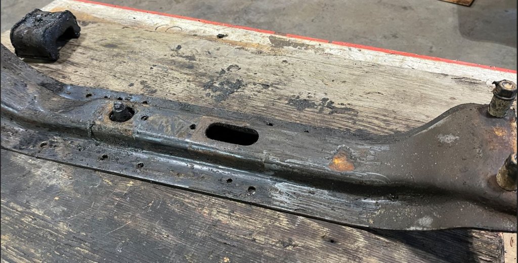

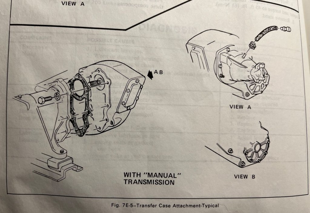

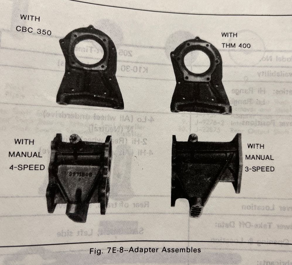

I suspect I have a problem is (at least partially) related to the mount the trans/transfer case is supported by. Does anyone have a diagram of this mount? I'm not even sure if there are one or 2 mounts. It appears the trans/transfer case are not directly bolted together, rather, there is an adapter (?) between them, and that adapter is what sits on the mount(s). Anyone know the part number(s) of the mount(s), or have a diagram? Any knowledge of videos showing a replacement procedure? Thanks!
