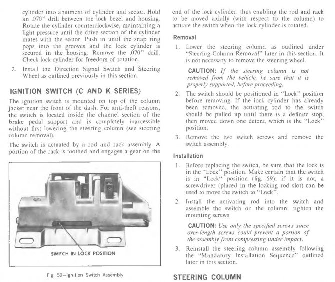

A little cheat sheet:

Thank you for this! Although for some reason the image doesn't show up for me when I click on it. Any chance you can blow it up?

I'm not sure what you mean but try this:
