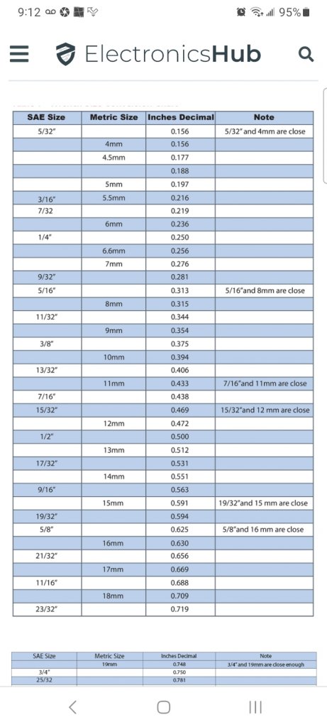

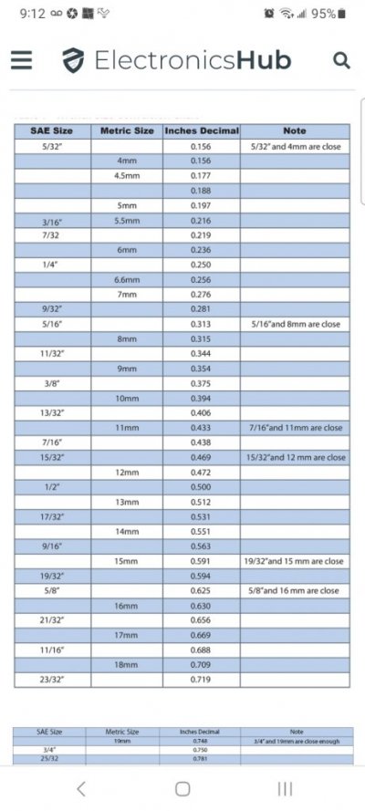

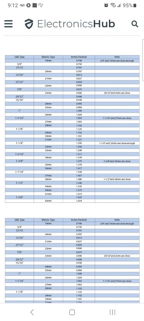

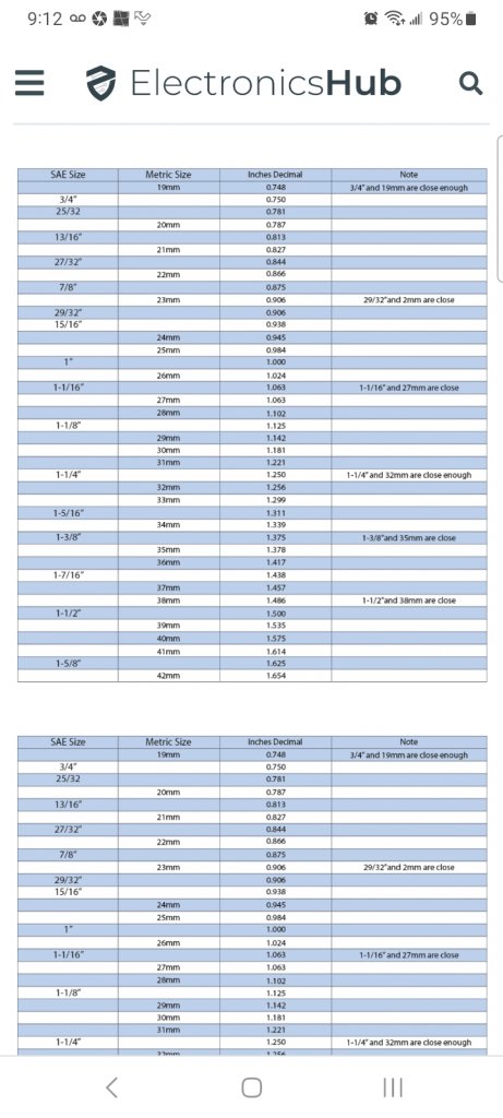

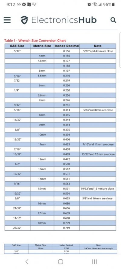

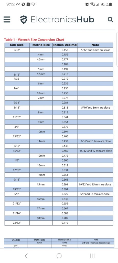

Not trying to insult anyone,I myself didn't know/think about this until I was working at the best shop I ever worked at,at 21. Since I was a kid working on my bikes,etc. If the wrench fit the bolt and would turn it that was good enough. Even after starting to wrench as a profession, still whatever fit was good enough,until a tech who had 10 or 15 years on me said you know Rick, insert whatever wrench size here isn't the same as x. Close but not the same. So I'm putting some pics up that show how close or different the wrenches are,hoping to save a few rounded fasteners or a few busted knuckles,or give someone the knowledge that there's another wrench just slightly smaller in case you are already dealing with a rounded fastener.

I've noticed this "close but not exactly correct size" on sockets on my OBS trucks (our squares didn't have that many metric fasteners IIRC). The blower motor bolts are 5.5mm, but a 7/32" socket was "close". The 5.5 fit properly and didn't have that "wiggle" felling that using the"close" one did. Also had a starter swapout on the Burb, that I used 14mm and 9/16" sockets on the mounting bolts. Probably other cases too but those are the ones I remember....

Thanks for posting...
If you see any of these for others besides SAE and Metric, I'd be interested, particularly for Whitworth and JIS.

Something else I've seen in this area: the lug nuts on the 8 lug trucks, and the later OBS 5 lugs like my Burb, are 7/8" hex. But some of these are 22mm, and while the two sizes are close, they're not the same. Saw this, doing brake work (or attempting to) on my crew cab. And a couple of the lug nuts are starting to get a little rounding on the corners; I'm figuring someone leaned on the trigger of an impact gun with a 22mm socket. The 22 fits on the nut, but the 7/8 fits it better. So I swapped out the sockets on my cordless impact gun, that I keep in the truck.
