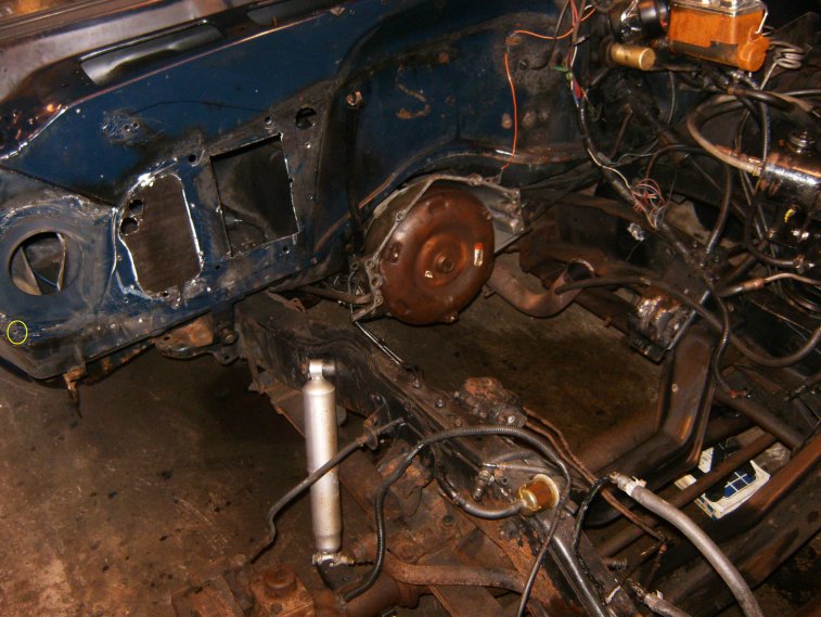

Why not install a factory A/C system? It is really not a huge job and you can probably find all the necessary components at the JY or on Craigslist for about $50 (maybe not incl a good compressor).
I recently picked up a complete system for something like $40.
The firewall went from looking like this:
To this (in about 12 hours):
The hardest part is locating the compressor mounting brackets. The normal P/S bracket is not used and there are a couple of other stiffeners etc. that must be switched.

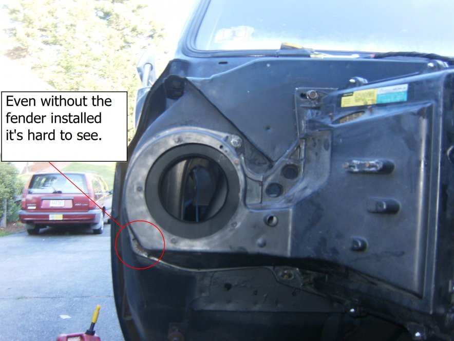

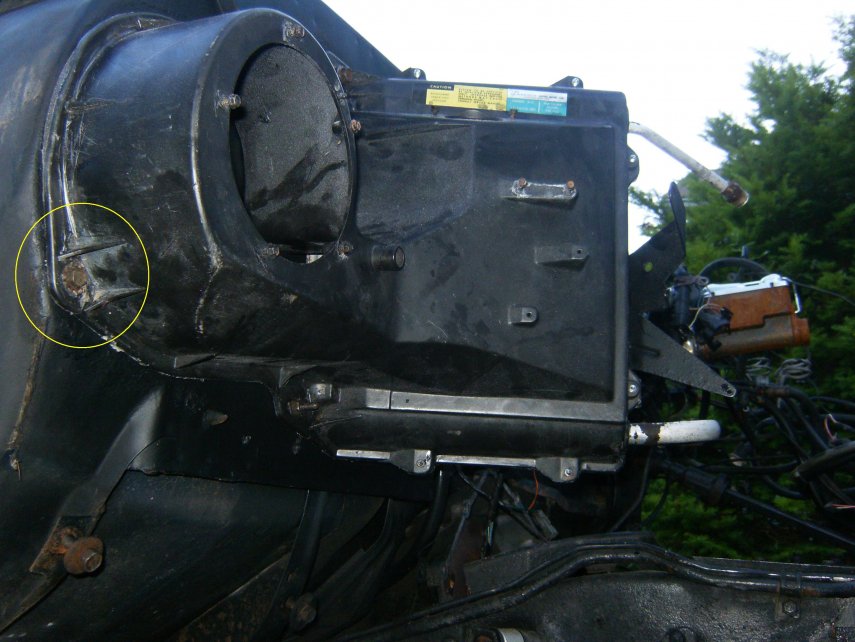

Believe it or not the biggest hassle is removing one particular sheet metal screw. It is buried behind the inner fender. I get it out by pulling the blower, reaching down into the plenum and screwing it out backwards. It is common to both A/C & non-A/C blower housings and really should be re-installed to prevent air leakage.
When I go to re-install, the fender is usually in place making it extremely hard to get the screw back in. As a work around, I use a short bolt/machine screw and drill the hole in the firewall out a bit. Glue the bolt in place in the housing with a bit of silicone and when everything is in place, reach down through the blower opening and thread a nut on the bolt.
