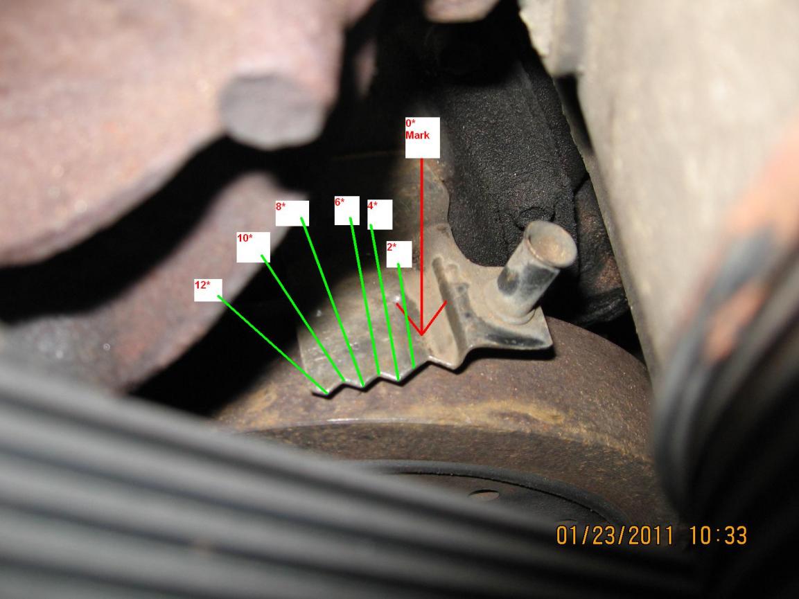

Are you sure the timing is set correct with the brown wire off? Possible that the timing chain jumped at all? :shrug:
it is at the 2nd notch from the left on the plate that is attatched to the timing cover that shows the timing and i just replaced the timing chain that probably hasnt run for more than an hour
try turning it a few degrees counter clockwise at a time, and see if it will fire and run on its own. sounds like you may have it too far advanced.

shouldnt i move it clock wise to retard it? i have already tried it where it was all the way to the right on the tab thats attatched to the timing cover.
So you do have a timing pointer?I thought you didnt. it should be dead center on 0*

Should be set to zero warmed up at normal idle with brown wire unplugged.

All TBi small blocks are 0*, 454's are 4*

I had the distributor timed at 0* and there wasn't a difference; the timing mark was almost vertical at idle and it didn't change smoothly when I gave it throttle.
